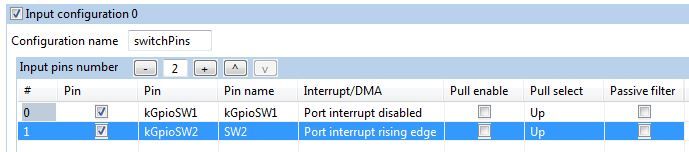

I created a KDS Project for the K22F Board. Under "Components" I see there are Interrupts and gpio pins already added. I am trying to toggle the RGB LED with interrupts so I went through I/O and renamed some pins etc... I also enabled an interrupt on rising edge for SW2 as seen in the image below:
I expected to see an interrupt service routine function in Events.c to write my code but there isn't any. How can you auto generate this code?

Your observation is correct. Right now PEx + KSDK does not generate ISR functions. If you open one of the KSDK examples (C:\Freescale\KSDK_1.0.0\demos) you will see that the interrupt functions are declared in a fsl_xxx_irq.c file, where xxx is the module. In your case you need to add or copy the file fsl_gpio_irq.c from (C:\Freescale\KSDK_1.0.0\platform\drivers\gpio) to your project.
By the way, I think this will be improved in the next release of PEx for KSDK and the interrupt handlers will be included automatically in Events.c as you suggested.
