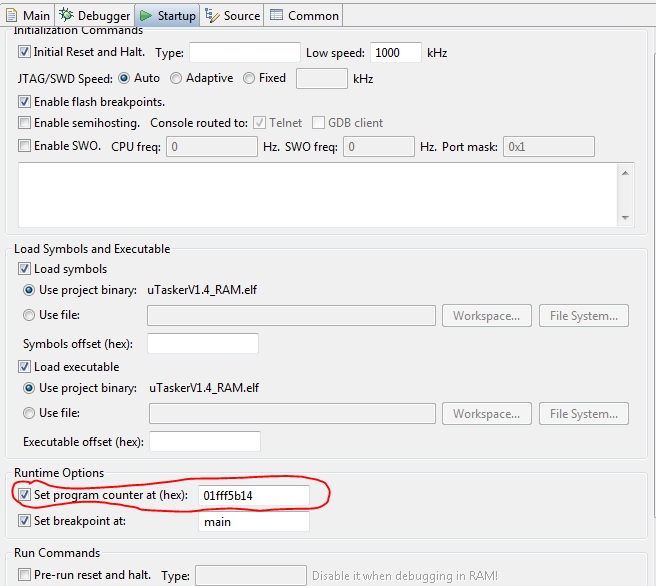

Using KDS, debugging in FLASH is essentially fine.
However when building for SRAM the code is correctly loaded to the SRAM but the debugger is trying to display the start location from FLASH - it loads the SP with the value in Flash at 0x00000000 and sets the initial program counter with the value in Flash at 0x00000004 (rather than from the equivalent information loaded to the SRAM)
Is there some (additional) configuration that is needed so that it can successfully debug in SRAM? With CW10.x, debugging s SRAM hasn't caused problems.

This is a general issue - I did find that with the KDS Beta version I could debug in SRAM but I had to manipulate the PC value since it was setting it from the Flash content (rather than the entry point) - then I could let the code run and perform usual debug operations.
In the lastest KDS I can't get the code to run in SRAM even after manipulating the PC accordingly - I can't work out why because I have to abort the debugger when I try since it doesn't respond any more.

I admit that I do not see much sense with debugging in RAM ;-), but anyway, I have experimented with it and had it up and running with Kinetis Design Studio V1.1.1. The important point to mention is that for OpenOCD and Segger J-Link you need to disable an option in the launch configuration. Details in RAM Target with Kinetis Design Studio and FRDM-K64F | MCU on Eclipse

Anyhow your project works fine but mine still won't with the JLINK settings that you use. When I download it simply starts running the code that is already loaded in the Flash, and of course overwriting the downloaded code to RAM in the process. The only way that I can find to work-around this is by setting the initial PC manually as follows:
I have to look up the start address from the MAP file and enter it in HEX (without any leading 0x).
then I can download and it correctly stops at the main() breakpoint and I can then debug normally.
Unfortunately I can't work out why the debugger somehow sets the PC value correctly for your project (???)
Also I have to have code loaded in Flash that sets the SP correctly (this is no big deal though) whereas I see that your project gets around this by setting the SP in code in __thumb_startup() (rather than in the reset vector).
