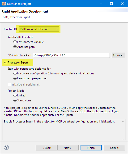

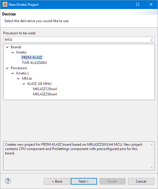

KL43Z is supported in Processor Expert only with the Kinetis SDK V1.3:
So you need the Kinetis SDK V1.3 for the KL43Z installed. Then you can do File > New > Processor Expert Project for it:
Point to your SDK location and enable Processor Expert:

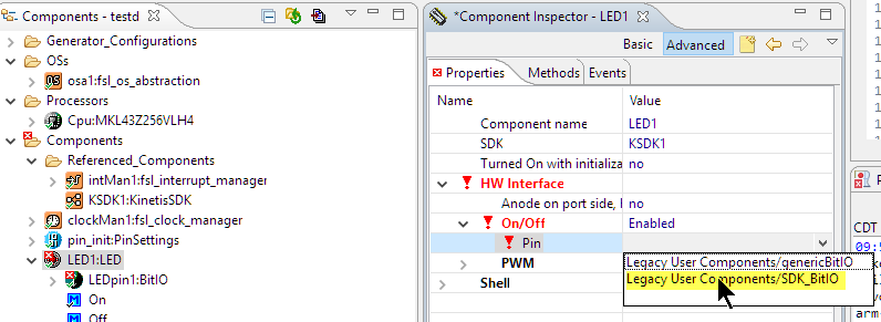

Some of the McuOnEclipse components can work with different SDKs, but then the steps are naturally different. If you want to use the LED component, then configure the SDK to be the V1.3 (what you are using):
You have to use a SDK_BitIO component like this:

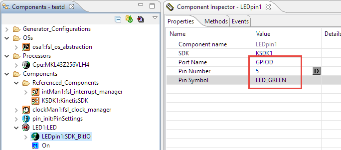

Add the fsl_gpio for the SDK 1.3.0:
LED1 is on PTD5, so specify this in the LED component:

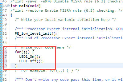

Generate code, and add your application code e.g.
