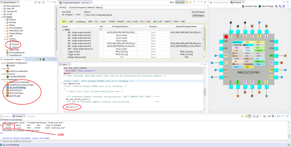

I'm using KDS v3.2 with KDSK 1.3 and PE. After creating a new project for FRDM-KL03Z I've initialized some PE components as spiCom1, gpio1... as shown in the next screenshot. Then I've just added a while(1) in main.c and the compilation result ends up in almost 14KB for the .text section that means a half of the total flash memory (32KB of the MKL03Z32VFK4).
Can anybody help me to reduce the generated/compiled code? I find it too much for a few components initialization.

The problem is less to do with PE and more to do with the KSDK components which are large, this is compounded by  KSDK's usage of ‘assert()’ in the driver code which uses the PRINTF function call which is huge.
Have a look at this https://mcuoneclipse.com/2016/03/09/dealing-with-code-size-in-kinetis-sdk-v2-x-projects/ it refers to KSDK 2 but I guess it is also relevant for 1.3.
