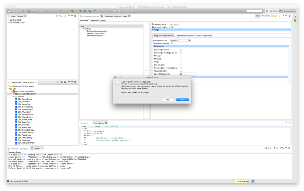

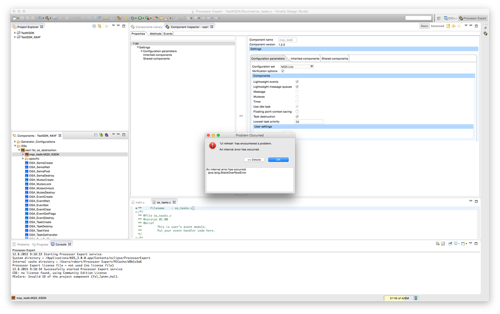

I'm using KDS 3.0 on MAC. And after updates always discover that some PE modules generate error java.lang.StackOverflowError.
At last update I find that mqx_ksds properties generate that error.
Is there any solution to increase java start or it is related to bug in code?
I always tested same function in Win7 at it work OK.
Thanks for answer in advance,
Robert

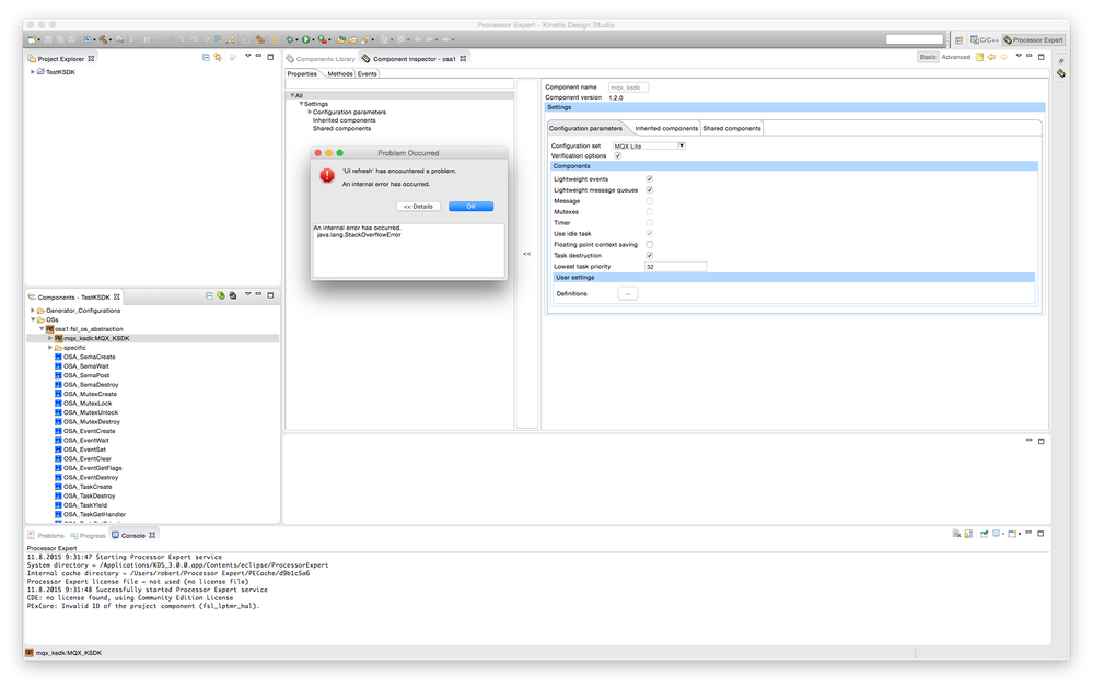

robertkonc
I'm testing heap size and it looks OK. When error occurs heap size is in range.
I take snap shot before and after I click to "mqx_ksdk" bean.
Heap size status in on bottom line.
I think heap size is not a problem.

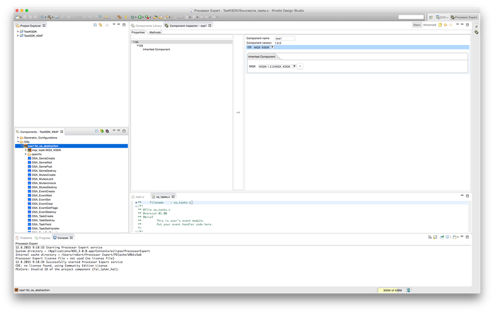

I was able to reproduce this problem and forwarded it for analysis to Processor Expert team. For now, as a workaround you can try to disable the Tabs view in Component Inspector before opening the mqx_ksdk component:
Sorry for the inconvenience.
Lukas

Hello Lukas,
Yes, that solve my problem for now.
This is old fashion CodeWarrior view of PE. And for me is more useful.
I did not know that this view exist in PE for KDS.
Thanks for that workaround. And I hope that PE team will find that error without big problems.
Robert
