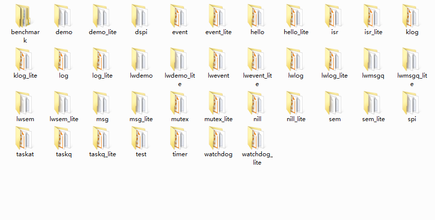

Hello yufei,
Before you use the example of SDK-MQX, please build the libraries.,  about the detail steps , please refer to here :
...\Freescale\KSDK_1.2.0\doc\rtos\mqx\MQX RTOS IDE Guides\MQX-KSDK-KDS-Getting-Started.pdf  ->
" 3 Building MQX RTOS example project and libraries " and  "4 Run the demo application "  .
"I refer to document the method on the create and copy the KSDK engineering examples" , please tell me which document, i will check it .

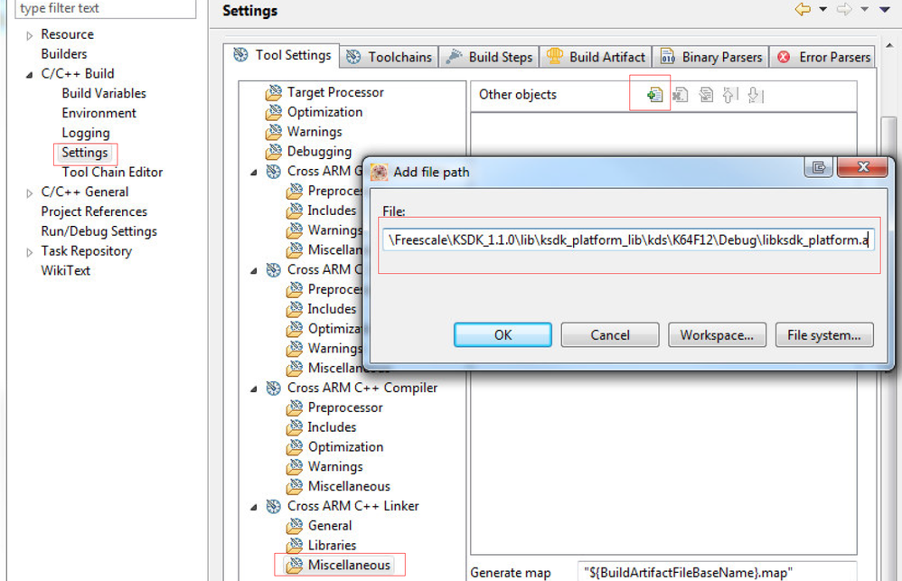

Hello ,
I have checked your project , for my KDS install path is different from you , and you configured the decision path , and it have so many path,
so  i have not change it .
And  form the first project ,i have checked you have not add the "*.a" lib file :
And i recommend you create new project , it is more bother to copy the demo under KSDK installation path .

wyflsxy
*.a is removed by me for a test,when i add *.a to be the lib,it was also wrong.and i have follow the document about How To: Create a New MQX RTOS for KSDK Project in KDS
but it also wrong when i copy code of example to my project

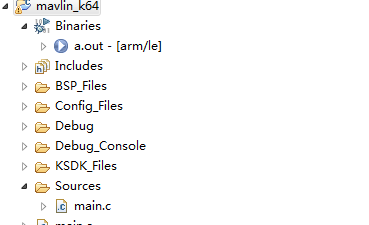

wyflsxy
and when I copy the example to my workspeaks
the error is :
make: *** No rule to make target `D:/workspeace/Copy (2) of uart_polling_example_frdmk64f/../../../../../../lib/ksdk_platform_lib/kds/K64F12/debug/libksdk_platform.a', needed by `Copy (2) of uart_polling_example_frdmk64f.elf'.
make: Target `all' not remade because of errors.
I really don't know how to do, please help me hurry up!thank you
5,969 Views
wyflsxy
and when I removed -nostartfiles -nodefaultlibs -nostdlib
the error is follow and there is not a *.elf but only an a.out
'Building target: mytask_k64.elf'
'Invoking: Cross ARM C++ Linker'
arm-none-eabi-g++ -mcpu=cortex-m4 -mthumb -mfloat-abi=hard -mfpu=fpv4-sp-d16 -O0 -fmessage-length=0 -fsigned-char -ffunction-sections -fdata-sections  -g3 -T E:\Freescale\KSDK_1.2.0\platform\devices\MK64F12\linker\gcc\MK64FN1M0xxx12_flash.ld -nostartfiles -Xlinker --gc-sections -L"E:\Freescale\KSDK_1.2.0\lib\ksdk_mqx_lib\kds\K64F12\debug" -L"E:\Freescale\KSDK_1.2.0\lib\ksdk_platform_lib\kds\K64F12\debug -L"E:\Freescale\KSDK_1.2.0\rtos\mqx\lib\frdmk64f.kds\debug\nshell" -L"E:\Freescale\KSDK_1.2.0\middleware\filesystem\mfs\lib\frdmk64f.kds\debug\mfs" -L"E:\Freescale\KSDK_1.2.0\middleware\tcpip\rtcs\lib\frdmk64f.kds\debug\rtcs" -L"E:\Freescale\KSDK_1.2.0\rtos\mqx\lib\frdmk64f.kds\debug\mqx_stdlib" -L"E:\Freescale\KSDK_1.2.0\rtos\mqx\lib\frdmk64f.kds\debug\mqx" -Wl,-Map,"mytask_k64.map" --specs=nano.specs -Xlinker -static -Xlinker -z -Xlinker muldefs -Xlinker --undefined=__isr_vector -Xlinker --defsym=__stack_size__=0x400 -Xlinker --defsym=__heap_size__=0x200 -o "mytask_k64.elf"  ./Sources/main.o  ./KSDK_Files/board.o ./KSDK_Files/gpio_pins.o ./KSDK_Files/pin_mux.o  ./Debug_Console/fsl_debug_console.o ./Debug_Console/fsl_misc_utilities.o ./Debug_Console/print_scan.o  ./BSP_Files/init_bsp.o ./BSP_Files/mqx_main.o  ./main.o  E:/Freescale/KSDK_1.2.0/lib/ksdk_mqx_lib/kds/K64F12/debug/libksdk_platform_mqx.a E:/Freescale/KSDK_1.2.0/middleware/tcpip/rtcs/lib/frdmk64f.kds/debug/rtcs/lib_rtcs.a E:/Freescale/KSDK_1.2.0/lib/ksdk_platform_lib/kds/K64F12/debug/libksdk_platform.a E:/Freescale/KSDK_1.2.0/middleware/filesystem/mfs/lib/frdmk64f.kds/debug/mfs/lib_mfs.a E:/Freescale/KSDK_1.2.0/rtos/mqx/lib/frdmk64f.kds/debug/nshell/lib_nshell.a E:/Freescale/KSDK_1.2.0/rtos/mqx/lib/frdmk64f.kds/debug/mqx_stdlib/lib_mqx_stdlib.a E:/Freescale/KSDK_1.2.0/rtos/mqx/lib/frdmk64f.kds/debug/mqx/lib_mqx.a -lksdk_platform_mqx -l_mqx_stdlib -l_mqx -lgcc -lc -lsupc++ -lm -lnosys
e:/freescale/kds_3.0.0/toolchain/bin/../lib/gcc/arm-none-eabi/4.8.4/../../../../arm-none-eabi/bin/ld.exe: warning: cannot find entry symbol Reset_Handler; defaulting to 00000410
'Finished building target: mytask_k64.elf'
