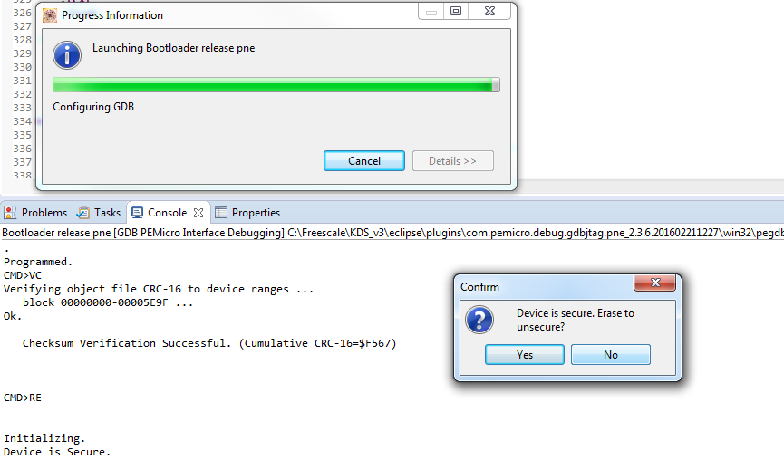

The flashing goes Ok until this moment. Than it asks me: Device is secure. Erase to unsecure? Yes or NO
So if I press Yes:
Device is secured. Erasing ...
Target has been RESET and is active.
WARNING - NO RESET SCRIPT FILE HAS BEEN CONFIGURED TO RUN!!!
TO MODIFY THE RESET SCRIPT SETTINGS, USE THE FOLLOWING MENU OPTION:
CONFIGURATION -> AUTOMATED SCRIPT OPTIONS
No breakpoints currently set.
Disconnected from "127.0.0.1" via 127.0.0.1
Target Disconnected.
Which obviously leaves me with empty device.

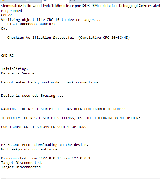

If I press No:
Cannot enter background mode. Check connections.
PE-ERROR: Error downloading to the device.
So it erases device anyway. The only way to program the device is disconnect debugger when the dialog appears.

The problem is that if I load a secure image, it erases it straight after loading, even if I choose not to. So I have no way of loading secure image and not have it removed after this dialog:

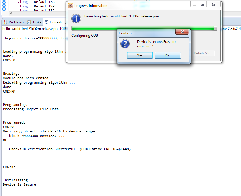

So I am flashing an image:
And receiving a dialog:
After I chose 'NO'. this is the result:
Obviously, device is erased and after resetting or power-cycling LED is not flashing.
Perhaps we are doing something differently...

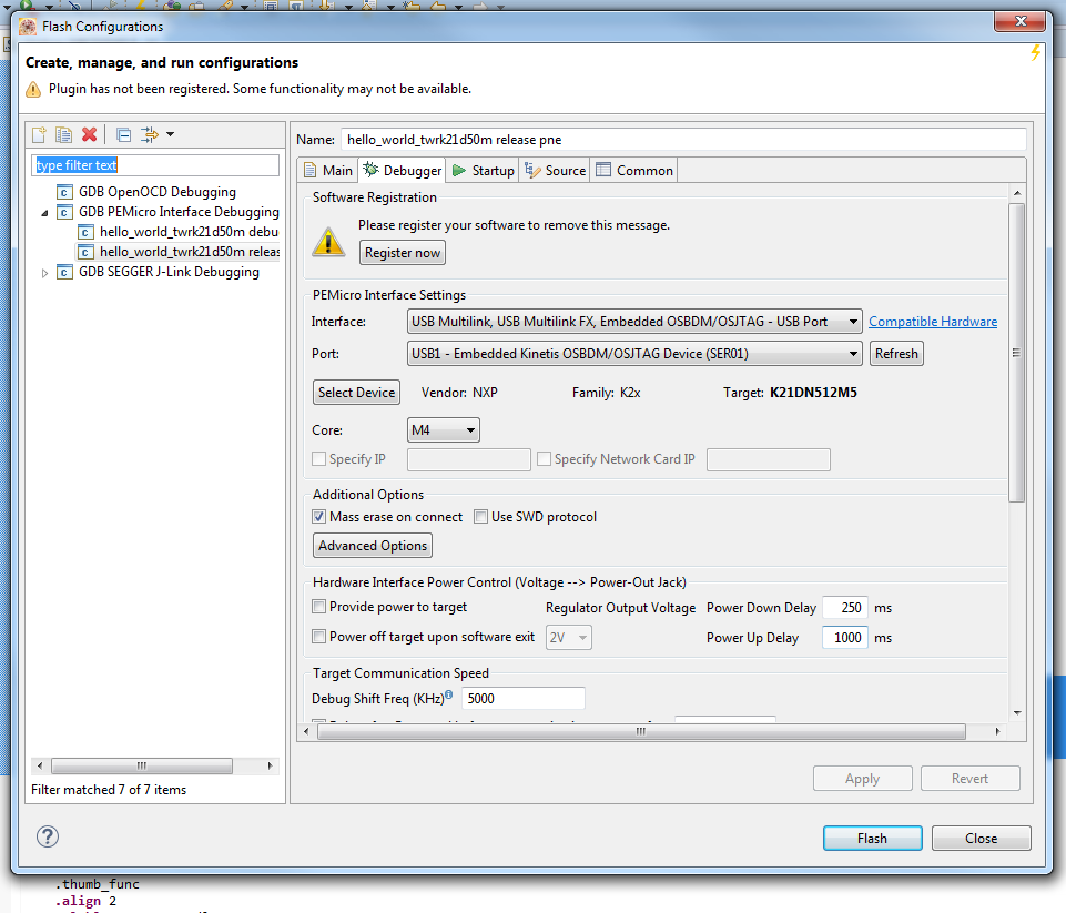

5,342 Views
v_snicarevs
Well the difference was that I had Additional options: Mass erase on connect 'Ticked'
Unticking it indeed made it work as it should...
