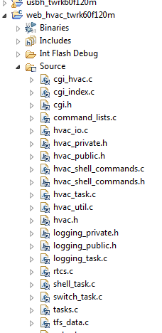

Yes, it works now. I was able to build the project without error. but I wonder if there is any plan to add the New project wizard to KDS anytime soon? That's very handy feature.
Also, I noticed that the source files are imported as "link files" rather than copy files once I import the project. Is there any way to change them to real files?
Cheers,
Sina
2,639 次查看
Hi SM,
About change the "link file" to copy file :
1,New a new folder use KDS,  "Source"
2, New some new c files under the "Source" , the name as the same as the  link file names . be careful use KDS, not create in the folder directly .
3, Find the link files' location , and put the link fies to replace the new C files in the Source folder directly.
4. refresh the project in KDS.
Perhaps there is an easier path, but this one works for me.
Alice
