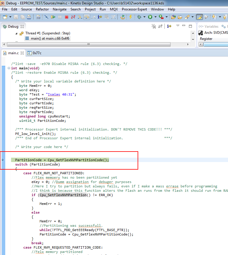

Hello.
I have been trying all the ways to use the EEPROM of the K10 MCU on KDS 3.1.0.
Here are the steps I made.
1.- In Processor Expert I set the EEPROM size to 2048 bytes and the EEPROM backup size to 32K. This gives a FlexNVM Partition code: 0x03, EEPROM Data Set Size: 0x23.
2.- I enable the Cpu_SetFlexNVMPartition(),  Cpu_SetFlexRAMFunction(),  Cpu_GetFlexNVMPartitionCode();
3.- I made a routine so it will only try once in the lifetime of the firmware to set the partition. It always fails to create, I assume that is because a function in Flash cannot modify it and have no idea how to execute the Cpu_SetFlexNVMPartition() to RAM.
4.- I tried from the Debug Configurations, Advanced Options,Enable  Partitioning for the device enabled with the value of 2303. In this process I also do a mass erase.
5.- After I do the step above I cannot debug, it goes to an error and I cannot step. I uncheck the option Enable Partitioning and check the Preserve Partitioning and uncheck the mass erase option. I can debug, the function Cpu_GetFlexNVMPartitionCode() returns a partition but partition size 3F instead of 24 and 0D instead of 03. I test an no Information is saved on EEPROM

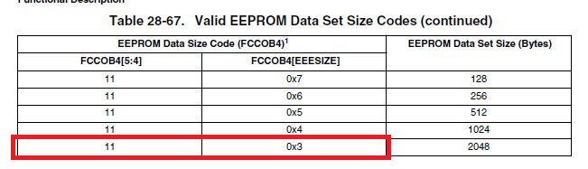

marek_neuzil
Hello all,
It seems that the issue is caused by incorrect value of the partitioning code. If you see the latest version of the K10P100M72SF1RM reference manual, there is the following table with possible value of EEPROM data set size codes:
 The only correct value is 0x33 for the 2048 Bytes of EEPROM data set size.
Note: The FCCOB4[5:4] bits are used for definition of the split factor on MCUs that contains two blocks of Flex NVM. But this MK10DX256VLL7 contains one block of Flex NVM and these bits must be set to 0b11.
Marek Neuzil

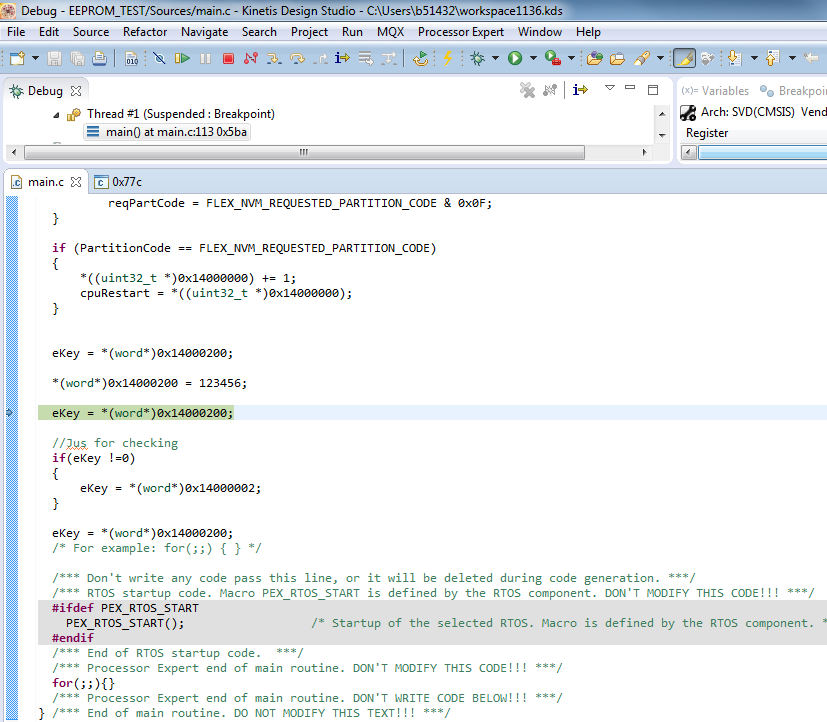

Hello Juan,
What about your debug error ? Please take a screenshot about it .
I test your project on my side , when debug , it have no error , below is some screenshot
about run the project step by shep:
Hope it helps
Alice

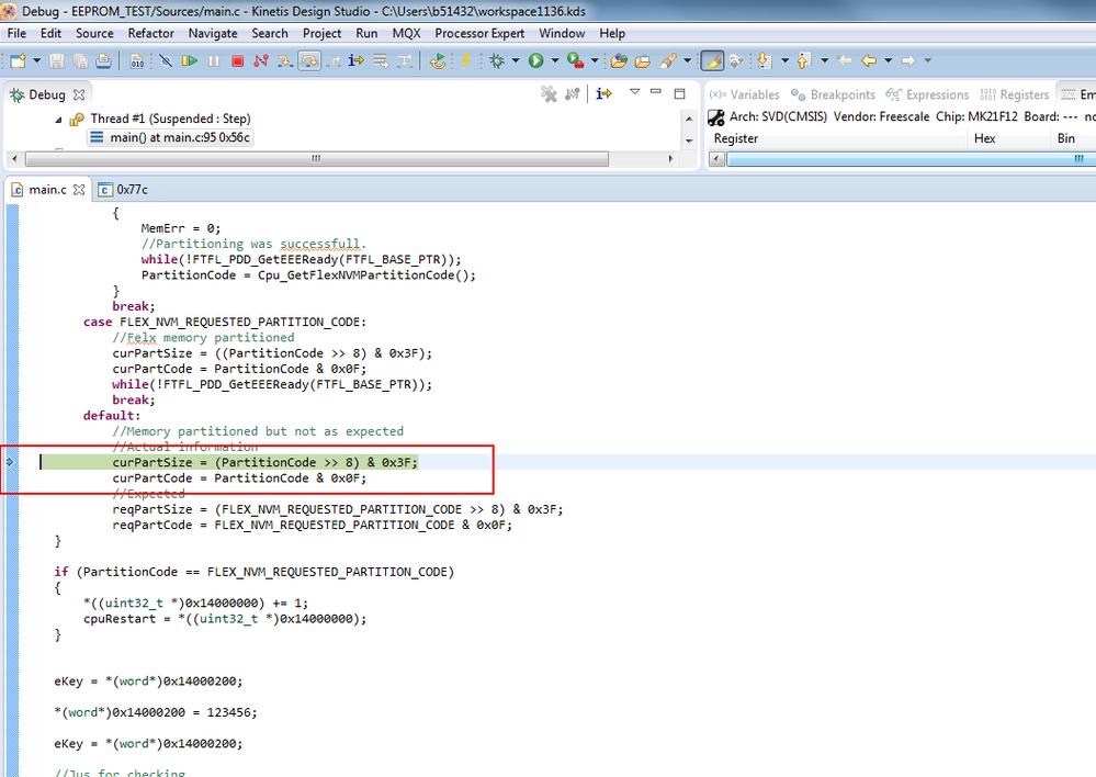

jfortuny
Hello Alice
Many thanks for your response.
In the screenshots the program goes to the default: case that is not working, it should go to the FLEX_NVM_REQUESTED_PARTITION_CODE: case. That shows that the EEPROM is not configured as expected, other value than 2303;
In fact I can write an read the EEPROM but when I restart, power cycle or debug (saving partition) the info is lost.

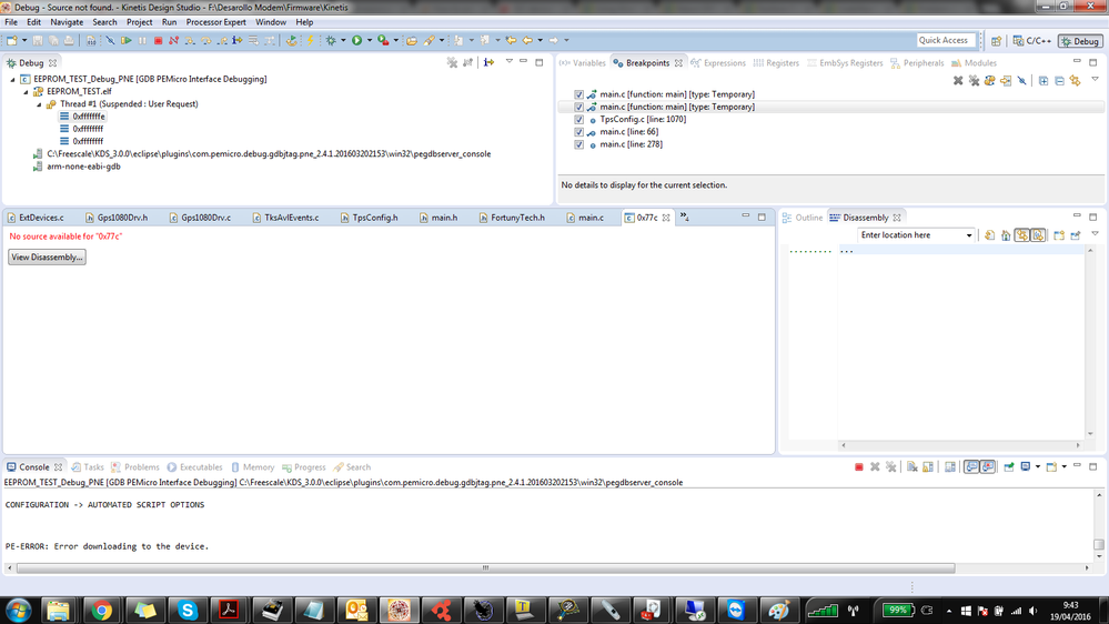

When I set the partition from the debuger is where I can't debug, I atach teh screenshots.
