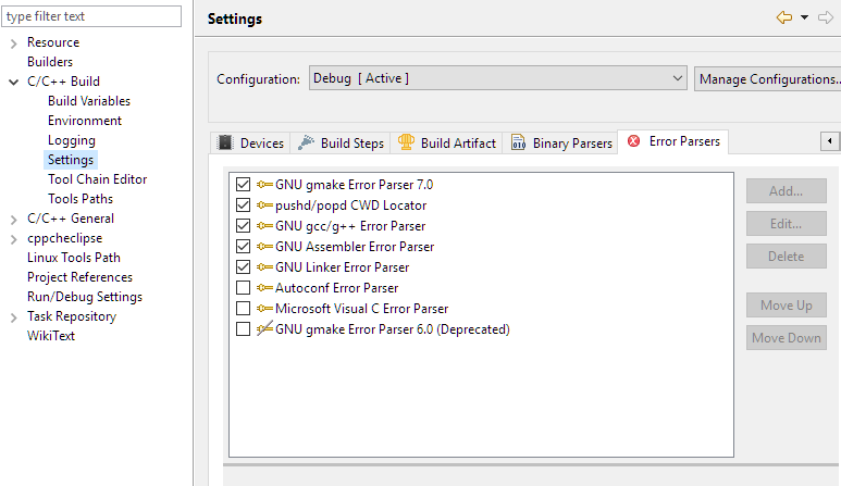

I checked the error parser options for both of our environments, they are the same.  We have GNU gmake Error parser 7.0, pushd/popd CWD locator, GNU gcc/g++ error parser, GNU Assembler error parser, and GNU Linker error parser checked.

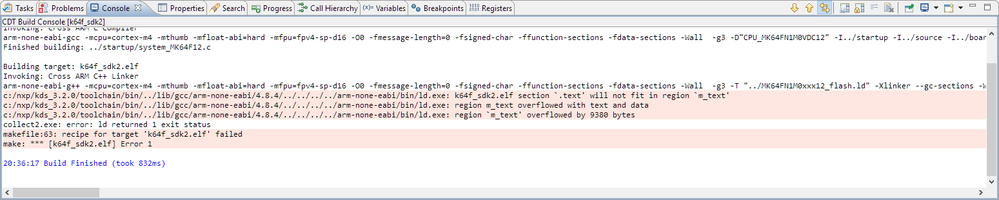

I tried it on my side, and it gets properly recognized:
These are my error parsers:
It might be very well that your KDS 3.0.0 version causes a problem because of the different make utility? The difference is in the KDS 'bin' folder (see Solving the 8192 Character Command Line Limit on Windows | MCU on Eclipse ). I have attached for you the 'bin' folder of KDS V3.2.0. You can give it at try (rename your 'bin' and use the attached one), maybe this helps?
