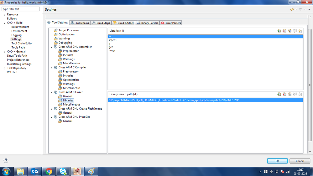

amitmahadik
Hi Alice,
               Apologies for the late reply. Please find attached the screenshots.
I have cross compiled the database library on a Linux machine and added the -L and -I paths.
I want to use the library in my project. I have modified the sample hello world code for the same.
Amit.

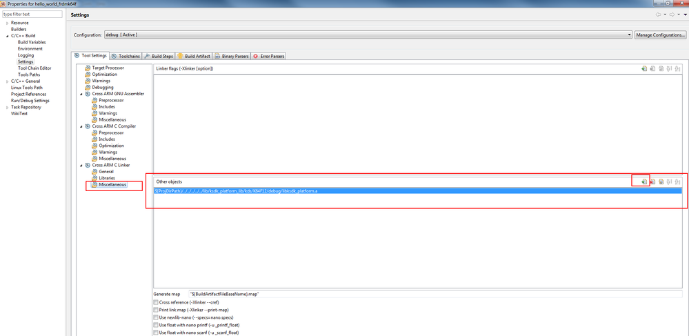

Hello Amit,
Please add your lib file to here :
check whether it can work well .
Hope it helps
