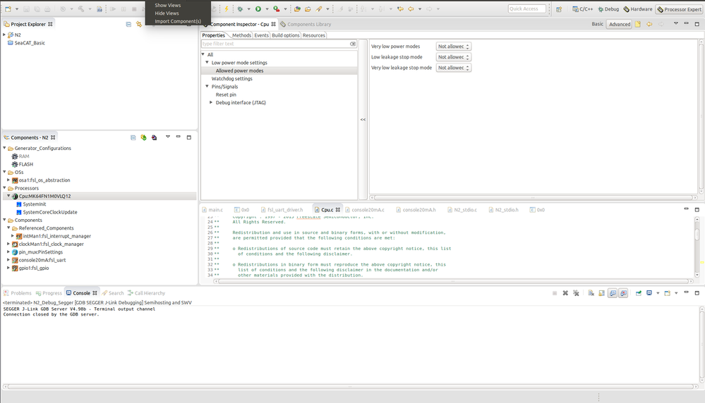

dquittman
I am having similar trouble with modifying the boot-time behavior of nNMI on K64FN1M0VLQ12. In my case, I am using processor expert on KDS3.0 on Ubuntu Linux 14.04. I can't seem to find the options tab you're talking about. When I double click on the CPU component, I only get the following options:
There's nothing to modify CPU interrupts/resets nor the NMI pin. Any ideas?
---DanQ
3,162 次查看
Jorge_Gonzalez
Hello Daniel Quittman:
Your project uses KSDK. The flash configuration options are not handled by Processor Expert anymore. Please follow the procedure I mentioned to disable the NMI pin.
