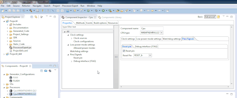

I am running the latest version of KDS (1.1.1) and KSDK (1.0.0), and the NMI Pin tab is missing.

This second image is from KDS 1.1.1

I see from your screenshot that you have added the Kinetis SDK to that project.
For SDK, the NMI pin is handled in the pin muxing, not in the CPU component.

DavidS
Hi Erich,
I have same results as Norm.
When I open KDS1.1.1 to a File-->New-->Kinetis Design Studio Project that is PE enabled, I do not see the "Common settings" listed.  Picture below.
Could some update be missing?
Could it be issue with new projects?
The Search did not find anything related to NMI either.
David

BlackNight

normansiegel
Thanks Erich.
Norm
3,161 Views
DavidS
So many rules.
Thank you Erich.
