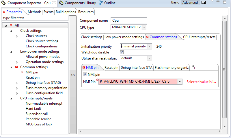

I am running the latest version of KDS (1.1.1) and KSDK (1.0.0), and the NMI Pin tab is missing.
This first image is from an older version of KDS:

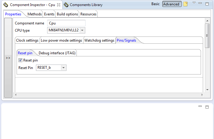

This second image is from KDS 1.1.1

I see from your screenshot that you have added the Kinetis SDK to that project.
For SDK, the NMI pin is handled in the pin muxing, not in the CPU component.

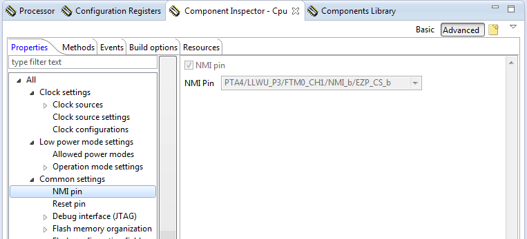

Hi Norm,
I think you are looking in the wrong place, it is here:
You do not have the left pane expanded.
In any case, you can search for a setting, see
http://mcuoneclipse.com/2014/06/24/finding-settings-in-processor-expert-components/
Erich
