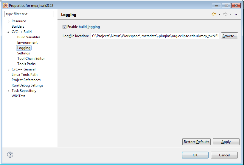

randyhermes
Hi Carlos,
Here is where I'm setting the logging path.
After round trip through source control it reverts back to the workspace.
NOTE: we are not archiving the workspace everytime.
Thanks - Randy
5,415 Views
Carlos_Mendoza
Hi Randy,
Apologies for the delay, the logging path property is saved on the file named "org.eclipse.cdt.ui.prj-{project name}.prefs" located in the folder "{workspace location}\.metadata\.plugins\org.eclipse.core.runtime\.settings".

randyhermes
Thank you Carlos,
That answer the final issue, explains why we keep losing the logging settings since we don't check in the workspace very often.
