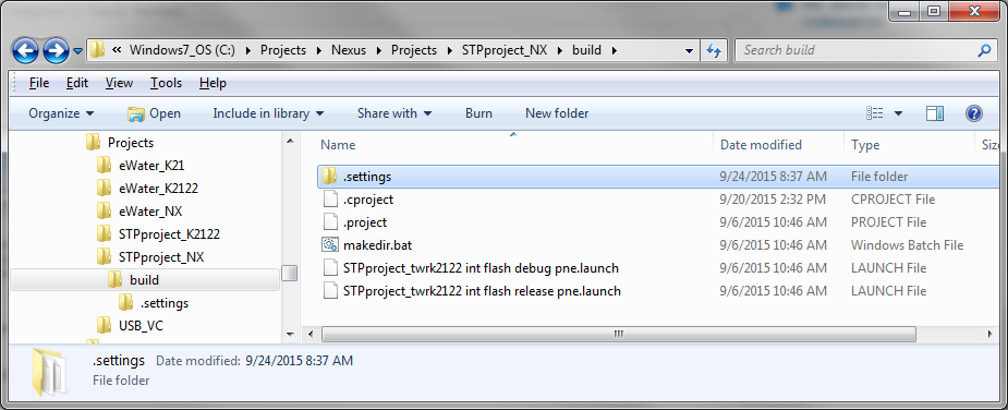

randyhermes
Hi Carlos,
My projects are outside of the workspace folder.  The .launch files are in the <project>\build directory.
Yes they are saved in source control.
When I retrieve a clean version from source control no configurations are listed under debug configurations even though .launch files are there.
I end up having to re-create them each time.
Sorry for taking so long to respond.  Been busy developing code.

randyhermes
Thanks Carlos,
This fixed the debug config issue.
Still resetting log files to workspace folder when I retrieve from source control.
NOTE: We are not saving workspace folder everytime we check in.
