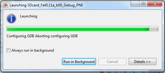

I am getting hanged up on the following screen:
It stays at 94% and never continues past this.  I also find it annoying that the Cancel button doesn't respond
once pressed.
By the way, the software compiles without errors and I tried re-building it several times and have also done
a clean on it.  If I load another software, it seems to load fine, so there isn't a hardware/multilink issue with
the board.
Can someone explain why this is happening?

Hi Erich,
I followed the link you sent me and it described the issue, exactly!  I followed your fix and sure enough, the debug execution
completed all the way through.
Excellent, thank you much.
I will update my KDS to 3.2.0 to avoid this in the future.
