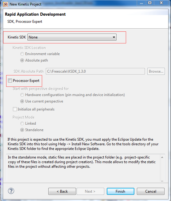

I am using Kinetis Design Studio version 3.2.0.
I have a problem. When I am going to create a new project I don't get the option to create a Kinetis Design Studio project like they do in the blinking LED project on Youtube. I only get the options shown in the attached .PNG file. Why?
I want to create a KDS 3.xx project.
I am shure it is a check box I have missed. It seems that there are a million checkboxes and I do not have the energy to go through them all. I want to make code to my project not configuring tools.
Regards.
/Bo

Hello Bo,
As Erich mentioned, you can select one of the latter two selection .
If you want to make code to your project not configuring tools,
in the "Kinetis SDK" select "None",  and uncheck "Processor Expert":
Hope it helps
Alice

These options all create Kinetis Design Studio projects:
The first one create SDK projects, while the last one creates both Processor Expert and bare projects for Kinetis Design Studio.
