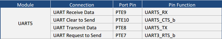

Dear sir,
              We buy board Kinetis KwikStik(k40) Board.I found problem is that the connector pin out PTE7 (B21) in user"s manual not the same pin.It is actually PTE11.please check any further change
1,002 Views
ivadorazinova
Hi Lijo Francis,
I attached you the explanation for your answer.
http://cache.freescale.com/files/32bit/doc/ref_manual/KWIKSTIKK40UM.pdf?fpsp=1pte7__.png
http://cache.freescale.com/files/32bit/doc/ref_manual/K40P144M100SF2RM.pdf
UART5 is a signification (name) on the board, it is not in connection with the chip. The signification (name) on the chip is UART3, so UART3RTS and is pin PTE7.
On port PTE11 is UART5RTS.
