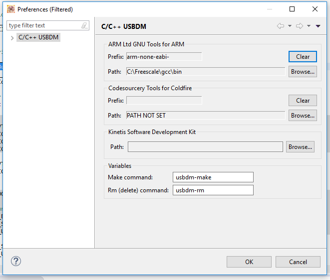

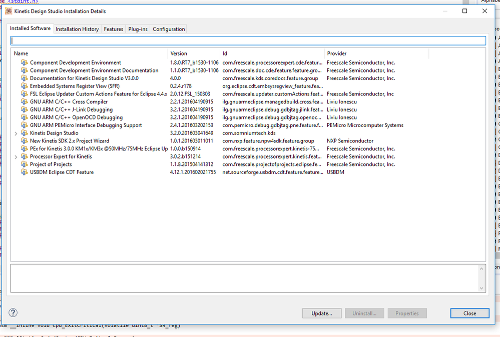

I definitly did not change anything on the toolchain, i used KDS3.2 right away, as it came from the installer. There was a 2015 version installed, you were right. Now I pressed update and have the following versions:
I made sure, that I've defined the arm-gcc nxp delivers:
(USBDM->Configure)

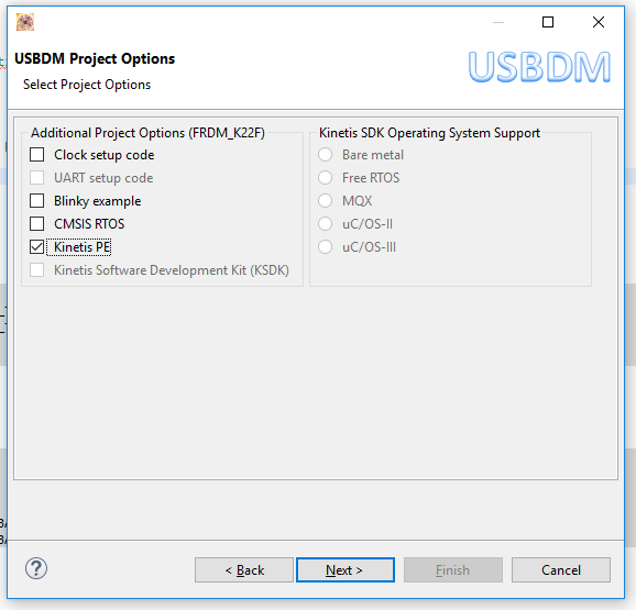

I decided to create a brand-new project with the USB-DM Wizzard.
and created a brand new project. I made sure, I selected the dialect you told me.
Hitting now compile returns the same error.

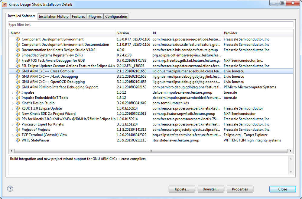

BlackNight
Hi Michael,
you are definitely not using the GNU ARM Eclipse build tool integration which comes by default with Kinetis Design Studio V3.2.0 which are these:
So it seems that you are a different kind of project/plugins?
What are you using?
Erich

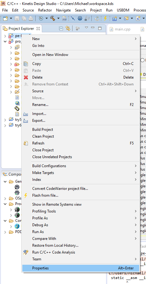

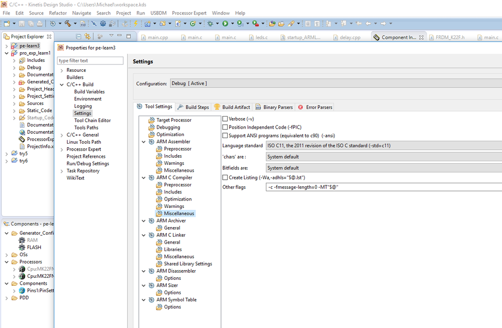

michaelheidinge
Dear Erich, thanks for the quick reply.
[Clicking on Property]->Projects->MISC->And then i found your option. It looked a litte bit different, but I think C11 is already enabled.
Sorry, didn't fix it. Any more ideas?
2,590 Views
BlackNight
Dear Michael,
I don't see that MISC page? Can you show a screenshot?
Erich

BlackNight
Hi Michael,
if __asm("....") is accepted or not depends on your compiler language settings. I think you ahve set it to C90 where asm() (and not __asm() is supported. I recommend you change the settings to C99 or C11:
I hope this helps,
