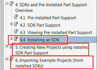

Develop Kinetis chips on MCUXpresso, we need install SDK into the IDE first .
For example , about this  MKV10Z32, first download theMCUXPresso SDK package for it
refer to  Generating a downloadable MCUXpresso SDK v.2 package
Then refer to  the MCUXpresso_IDE_User_Guide -> 4.4 Installing an SDK  to install .
(I attached this DOC to you .) .
You can also refer to this user guide to crate new project and import demo project of SDK.
