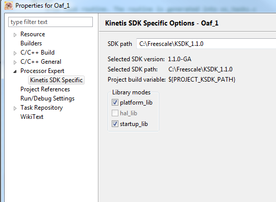

I'm using KDS-2.0.0 and KSDK-1.1.0 and have some troubles. I want to link KSDK from libraries and not include the sw into my project.
This could be done from Project->Properties->Processor Expert -> Kinetis SDK Specific
In KDS-1.1 I could select
    platform_lib AND hal_lib AND startup_lib
Now I could select
     (platform_lib OR hal_lib) AND startup_lib
There is no HELP available that I've found so I have selected platform_lib AND startup_lib.
Is there any explanation regarding this choice?

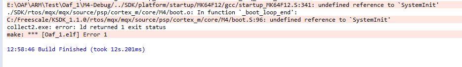

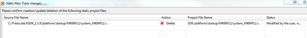

When making my project now I got a message telling about an unneeded file:
But when this file is removed my project will NOT link:
When investigating this, I've found that SystemInit() is located in the file which was presumed no longer needed.
Is this a bug in KDS? Or is there some additional flag that I need to set?

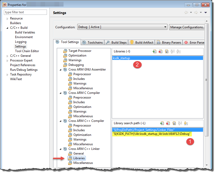

When those options are checked, Processor Expert do not handle the corresponding KSDK source files. In this case if you check the "startup_lib" option, as the message indicates the system_MK64F12.c file is removed and you need to include the compiled startup library. For this you have to:
1) Import the startup library project (File -> Import -> General -> Existing Projects into Workspace). The project is located in: C:\Freescale\KSDK_1.1.0\lib\ksdk_startup_lib\kds\K64F12.
2) Build the project. Then a file with name "libksdk_startup.a" should be generated.
3) Finally include this file in the linker options of your project (Properties -> C/C++ Build -> Settings -> Cross ARM C++ Linker -> Libraries):
Then your project should build with no errors.
