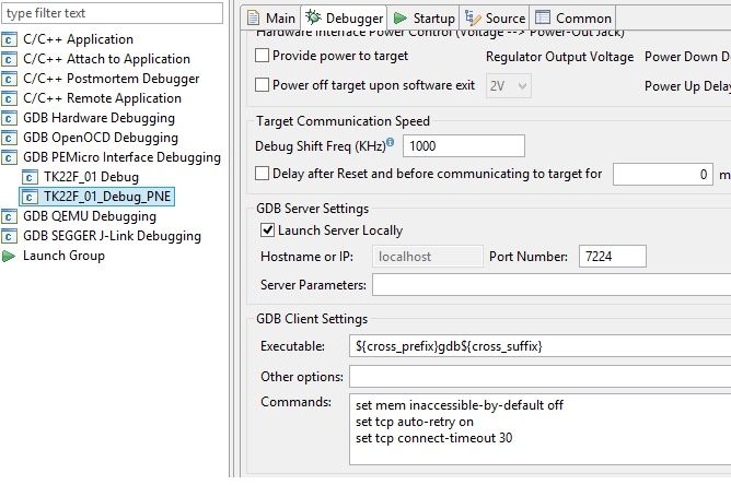

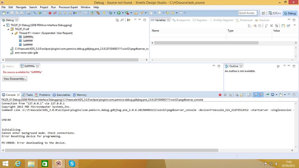

KDS20 debug/programming = error, I unistall it.
NOW KDS30 error =;
I use Multilink C, conection K22F  ok.
How to Configurations for ( Debug and programming flash )?
See:
Connection from "127.0.0.1" via 127.0.0.1
Copyright 2012 P&E Microcomputer Systems,Inc.
Command Line :C:\Freescale\KDS_3.0.0\eclipse\plugins\com.pemicro.debug.gdbjtag.pne_2.0.8.201504092111\win32\pegdbserver_console -device=Freescale_K2x_K22FX512M12 -startserver -singlesession -serverport=7224 -interface=USBMULTILINK -speed=1000 -usejtag -p
CMD>RE
Initializing.
Cannot enter background mode. Check connections.
Error Resetting device for programming.
PE-ERROR: Error downloading to the device.

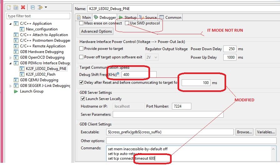

hi,
KDS30, IT NOT DEBUG
KDS30 DEBUG AND PROGRAMMER OK.
my programmer it ( P&E Multilink Universal ).
it not run in MODE ( SWD ).
Carlos.

Greetings,
If you had issues connecting in both KDS2.0 and 3.0, then the issue is most likely in hardware and not in the software.
1) Are you using any custom adapter, custom ribbon cables, external watchdog, a reset circuitry, or other unique hardware?
2) Has this setup worked in the past? Or is this your first attempt? Do you know if the P&E hardware and the board are in working condition?
3) What P&E hardware interface are you using?
Takao YamadaP&E Microcomputer Systems
