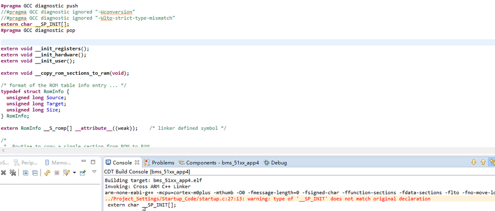

In the startup.c file, the stack pointer declaration _SP_INIT as char[], when I add LTO option with linker, there's a warning: "warning: type of '__SP_INIT' does not match original declaration", I want to disable it, and not know how?

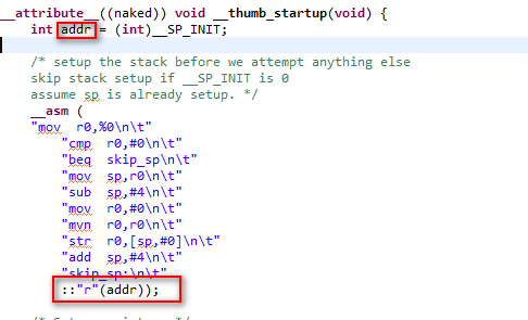

The local variable optimized away when I removed the __attribute__(optimze("O0"))
As compare, I remove the comment, and it display as following

That's normal and expected with higher optimization settings. If you want to keep it, the usual way is to define the variable with 'volatile'.

vaughn
hi Erich, I found local variable will optimized away even if volatile added, and GCC's version is arm-none-eabi-gcc 4.9.3.

I have documented how I have been fixing that warning message caused by -flto in GNU Link Time Optimization finds non-matching Declarations | MCU on Eclipse
I hope this is useful,
Erich

vaughn
Erich, that doc helpful, thanks.
