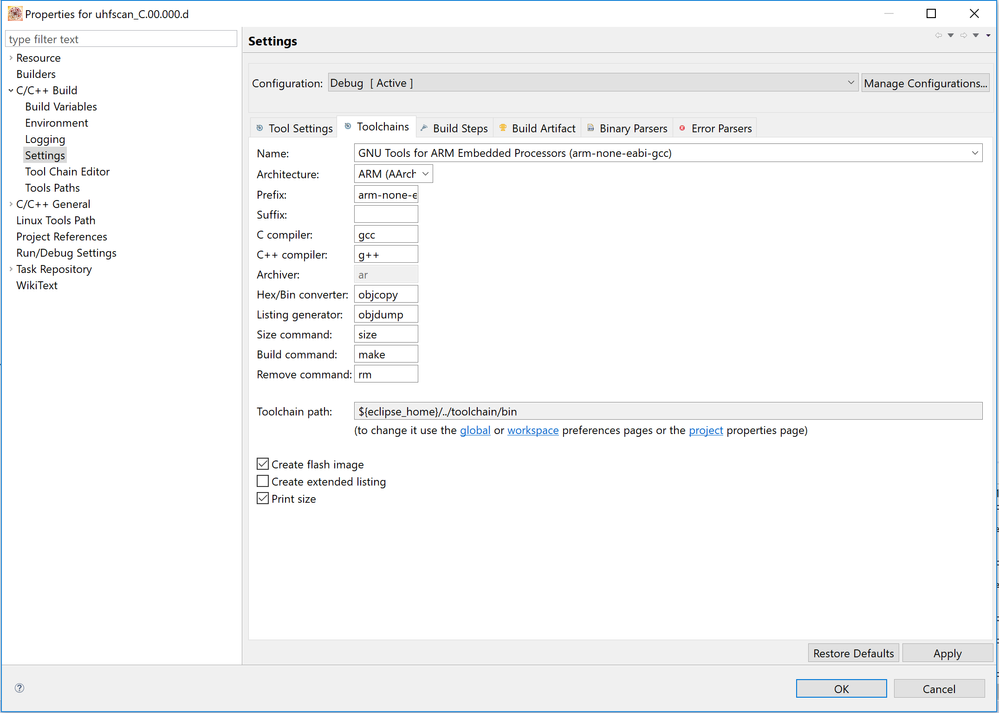

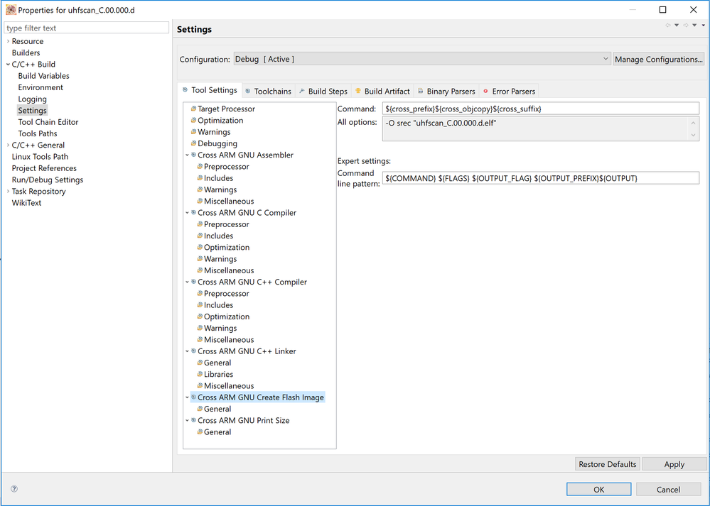

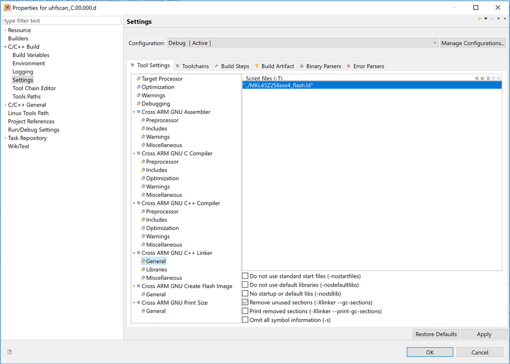

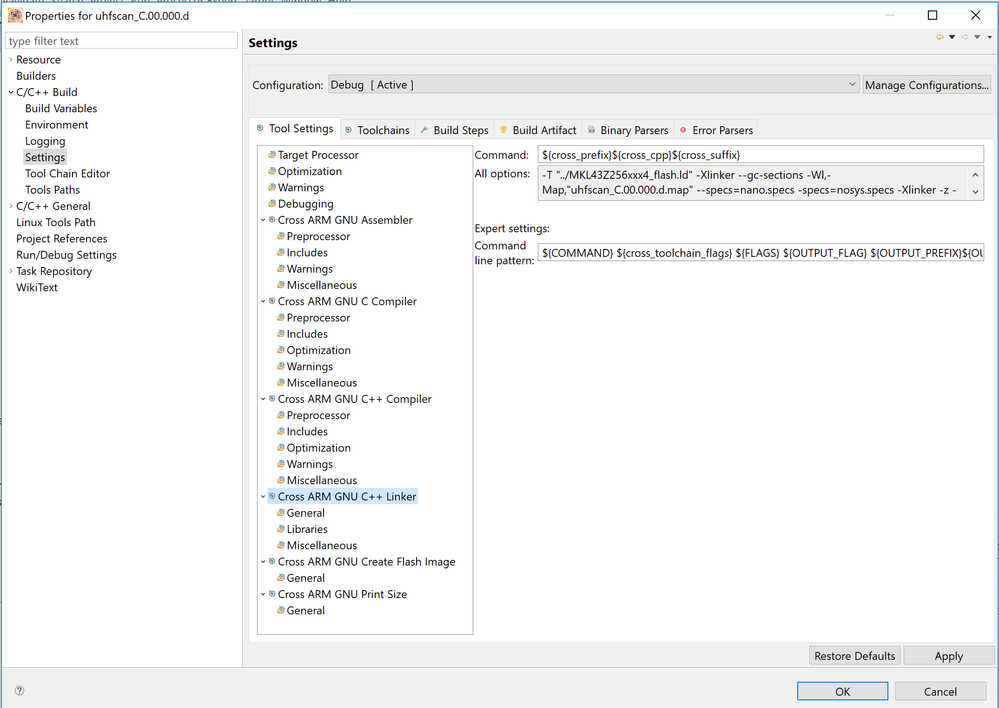

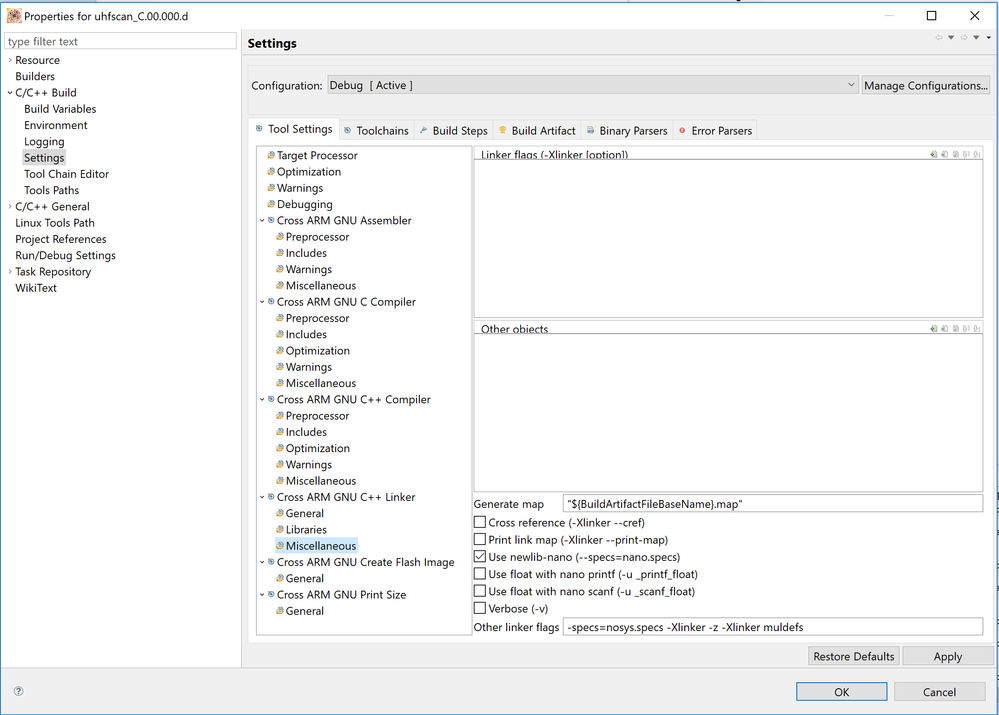

I read your article in an attempt to debug in RAM. Unfortunately, since I'm using KDS3.2.0 and there is anything in the configuration setup that looks like the menu you showed in Processor Expert. I can't find where I can switch back and forth between RAM and Flash in this version of KDS.
Here are a few snap shots of the Build Configuration setting menu:Capture1.PNGCapture2.PNGCapture4.PNGCapture3.PNG
However, I found a checked box named "Create flash image". If this is it, then it is checked and the program should be in flash, isn't it right?Capture5.PNG

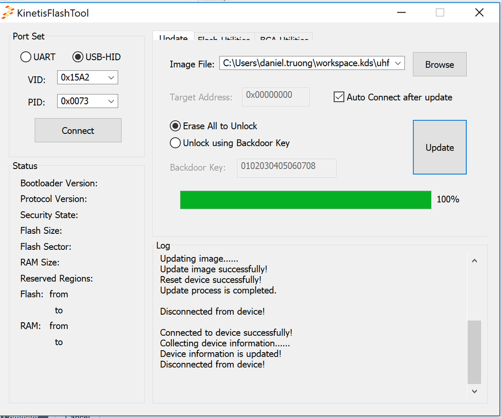

By the way, I also tried to download the firmware with KinetisFlashTool through the USB channel via the ROM bootloader. The tool indicated that the image was successfully updated.Capture8.PNG
However, after a power cycle, the program never started. Could it be loaded in a wrong area of flash that the microcontroller can't retrieve it after it exits the ROM bootloader?

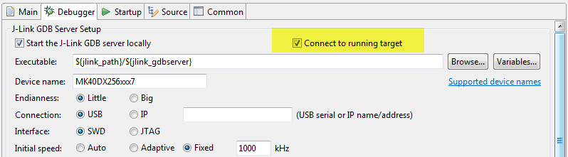

From your screenshot, you use linker file MKL43Z256xx4_flash_ld. I think you should burn code to flash. You can check Flash memory it by "connect to running target". after launch debugger, check memory window. thus you can confirm if there is any code in flash.

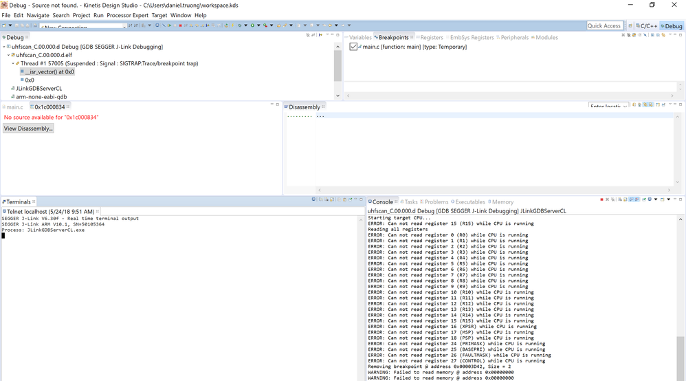

I attempted to launch the debugger with the box "Connect to running target" checked, as soon as the file is loaded, I couldn't start the program because the Resume button (under Run menu) was de-highlighted. Only Suspend and Terminate buttons are available. And based on the Console log below, it looks like the micro can't read from memory address 0x0000000000. Does that mean there's nothing in flash, is that right?Capture1.PNG
This behavior is different if I ran without connecting to target. I could control the program from the beginning by pressing the Resume button.
