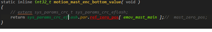

I have a behaviour with KDS.
The editor is outlining as error an expression, but build time no error is present.
This begun to happen since some time, after the same project has correctly worked for months.
Suggestions???
Thank You

Hi Pietro,
maybe I don't see it, but I don't see an error in your screen shot?
As a piece of information: Eclipse is using the 'Indexer' for its internal parsing. So it could be that your Indexer database somehow is not correct. See Fixing the Eclipse Index | MCU on Eclipse .
I hope this helps,
Erich

pietrodicastri
Senior Contributor II
Yes ,,
Rebuild the index was sufficient,,,
