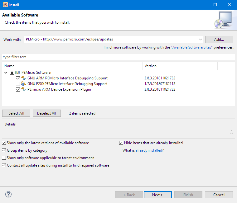

Hi Claudio,
have you updated as well the PEMicro plugin using Help > Install new software using the P&E update site?

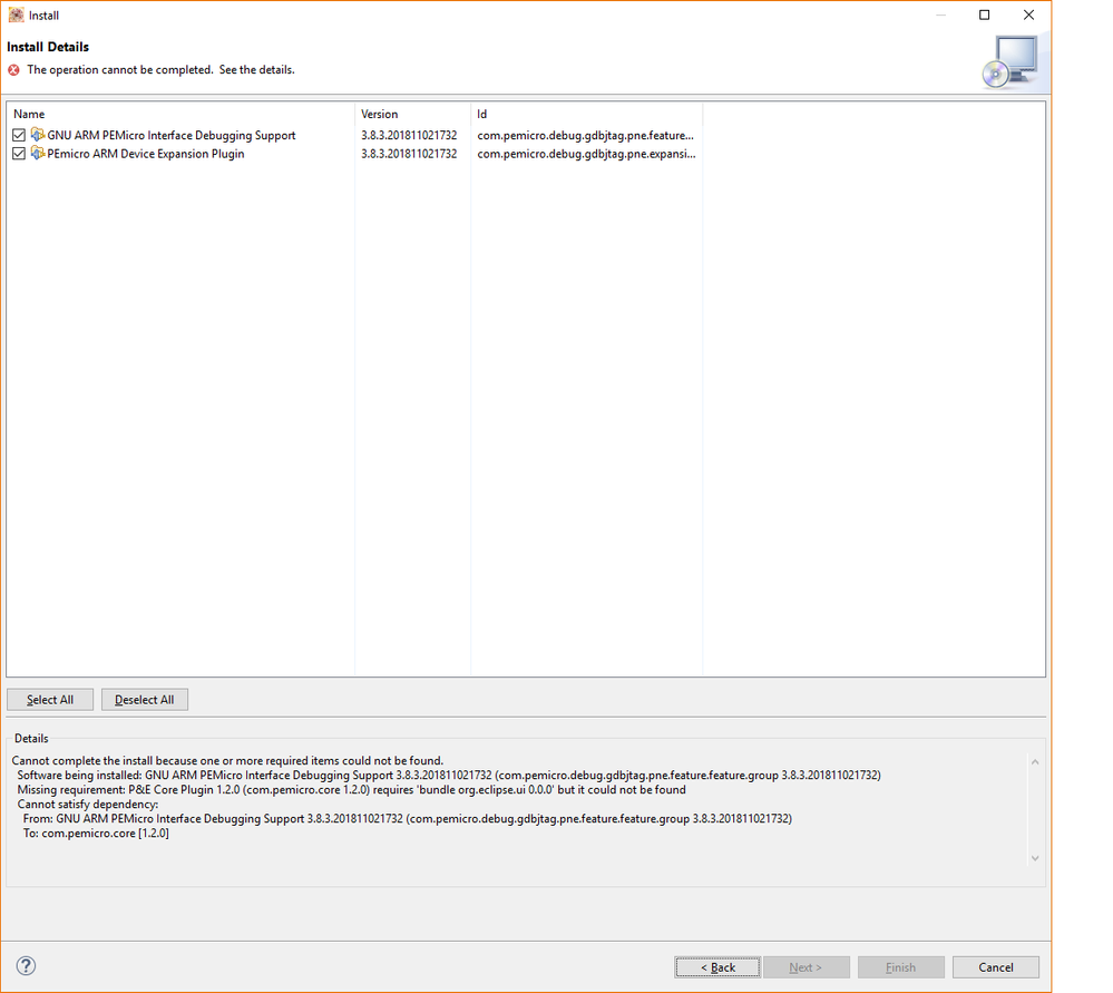

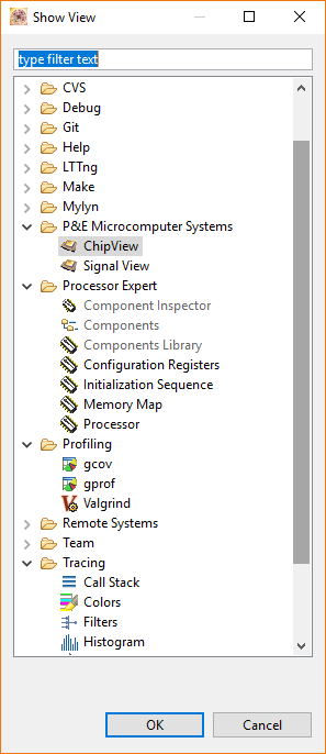

claudiobrunelli
Hi Erich.
Thanks for your assistance.
Yes I have updated the PE plugin.
But at the beginning, trying to install, I had an error as you can see from attached file named Image_B.

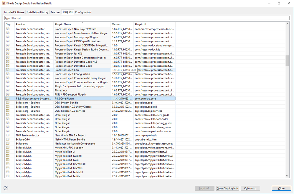

So I re-installed KDS IDE, updated pe plugin and checked again what I had installed.
I realized that I didn't have the right requirements named P&E Core Plugin 1.2.0 but I have P&E Core Plugin 1.1.43.
May be this the wrong situation (Image_C) ? Can you tell me how I can install P&E Core Plugin 1.2.0 ?
The view of PE that I have (without real time expression) is in Image_D.
