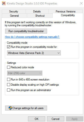

arnaldogomes
Hi guys!
I found a solution for my problem. I running the KDS using the compatibility module of Windows (Windows Vista - Service Pack 2).
After that modification the KDS stayed fast!

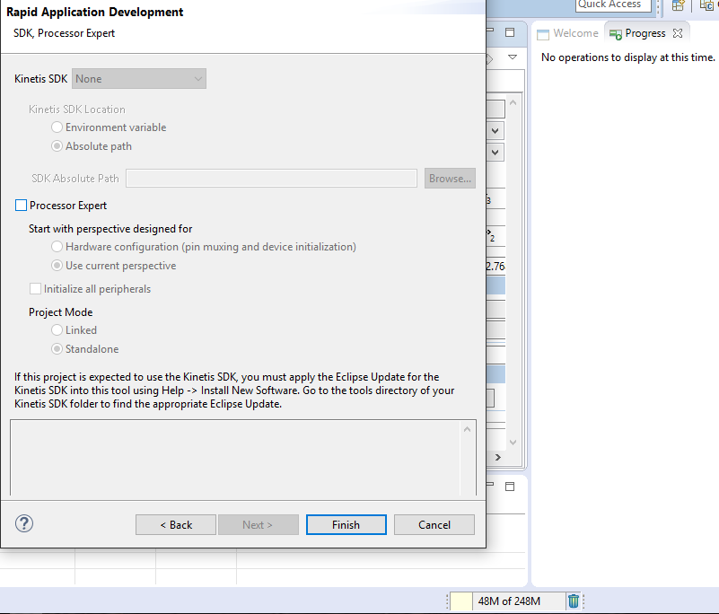

MarekTrmac
Hi, Try opening Progress veiw using main menu - Windows - Show View - Other - Progress. It may show any operations, that are running on background.

arnaldogomes
Hi Marek!
Follow "Show heap status" and "Windows - Show View - Other - Progress"
