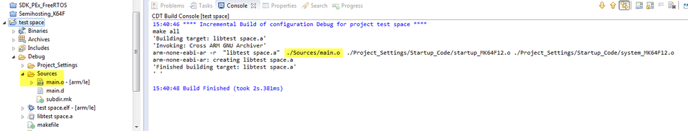

Another issue with KDS V1.1.0 and a static library project.  (Started here KDS Static Library Project - Bug Report +Fix for future versions)
When the archiver is invoked,   It is not passing the correct path of the object files to the archiver.
Here is the example:
I am building CMSIS DSP 3.2.  The compile phase runs correctly.    All of the object files are stored in “./Debug/Sources/DSP_Lib/Source/…….”
So,  for a C file that is located in
“.Sources/DSP_Lib/Source/FilteringFunctions/armcorreclate_fast_q15.c”
The Object File will end up here:
“./Debug/Sources/DSP_Lib/Source/FilteringFunctions/armcorreclate_fast_q15.o”
“Debug” is the current eclipse build configuration.
Here is the issue. When the archiver is invoked it is passing the path to the source file, not the object file: (I cutout most object file paths for clarity)
make all
'Building target: libCMSIS_DSP_3.2.a'
'Invoking: Cross ARM GNU Archiver'
arm-none-eabi-ar -r  "libCMSIS_DSP_3.2.a" ./Sources/DSP_Lib/Source/TransformFunctions/arm_bitreversal.o./Sources/DSP_Lib/Source/BasicMathFunctions/arm_sub_q7.o ……………………………..
arm-none-eabi-ar: creating libCMSIS_DSP_3.2.a
arm-none-eabi-ar: ./Sources/DSP_Lib/Source/FilteringFunctions/armcorrelate_fast_q15.o: No such file or directory
make: *** [libCMSIS_DSP_3.2.a] Error 1
Notice that it is passing the path “./Sources/DSP_Lib/Source…..”    not “./Debug/Sources/DSP_Lib/Sources….”

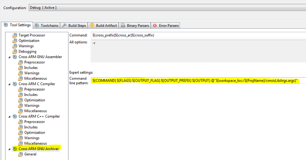

martynhunt
Hi Eli,
The Windows command line length limitation can be avoided by bundling your input files into a single arguments file. I have edited the library project to include an arguments file. The arguments file is included like this:
Unfortunately I have not yet been able to add 'clean' support, so you must perform a manual clean by deleting the "Debug" or "Release" folder manually.
Please let me know if this method works for you, and I will keep you posted if I find a way to include 'clean' support.

danielkraemer
Hi Erich,
I understand that it is a Windows issue and it will take time to implemment a native solution.
I have tried to shorten the path to the object files using relative paths as you suggested.
It worked for a while, but my project is still growing as my team is still adding more files and folders due to different modules and we reached the 8191 character limit again.
To avoid that problem, we choose to try the workaround pointed by Martyn, it's not yet automated, but it allows us to continue developing the application:
1. In Debug folder, created a file "ProjectName.args"
2. Copy object files paths into "ProjectName.args" ; for this, in Debug folder we looked into subdir.mk files and retreived the information under the variable OBJS.
3. Inside "ProjectName.args", set an object file path per line, and be sure to put the name between " " (ex.  "./Sources/main.o" )
4. In Project "Properties"/"C/C++ Build"/"Settings" ->  "Tool Settings Tab" -> "Cross ARM C++ Linker":
  - We had to modify the command line pattern: changed the argument ${INPUTS} to -> @"ProjectName.args"
As I said, this is just a "quick" workaround to turn the setup operational again, the downside is that it's not automated, so care must be taken when a file is added or deleted !!
I hope this information is useful to someone.

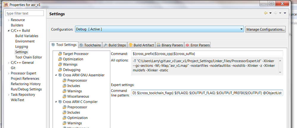

larrykoos
Daniel,
Here is a workaround that automates the process you've described:
First, create a textfile called makefile.defs in the project's root directory. This file is referenced in the autogenerated makefile in an include statement as shown and is provided for the developer to influence an auto-generated make.
ifneq ($(strip $(S_UPPER_DEPS)),)
-include $(S_UPPER_DEPS)
endif
endif
-include ../makefile.defs
# Add inputs and outputs from these tool invocations to the build variables
# All Target
Use this file, makefile.defs, to copy all the compiled object files and libraries into a file which we called ObjectList. The makefile script we used is:
$(shell rm ObjectList)
$(foreach obj, $(OBJS), $(shell echo $(obj) >> ObjectList))
$(shell echo $(USER_OBJS) >> ObjectList)
There is probably a more efficient script than this but I'm not a script wiz.
Finally, edit the project linker settings' Command Line Pattern to remove the reference to $(INPUTS) and replace it with @ObjectList
Hope this helps

BlackNight
Hi Eli,
It is passing the correct path to the object file. The current folder for the 'ar' program is the debug folder, and inside the debug folder there are the 'source' folders replicated (with the object files). The following picture illustrates this:
I think what you are running into is a Windows limitation: your command line length to 'ar' is probably larger than 8192 characters, and then it fails with that message.
Just for a test, try to reduce the number of files/objects to archive, and I think it will work.
So if this is indeed the case: shorten the path length, or make two or more libraries.
