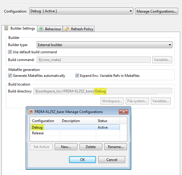

The build directory is set to ${workspace_loc:/project_name}/Project_Flash but this is not the location that it should be in for this system. CW10.5 allows the correct location to be set here but KDS has the field greyed out.
It can be set when "Generate Makefiles automatically" is disabled but gets set back to the unwanted default when the check boy is activated again.

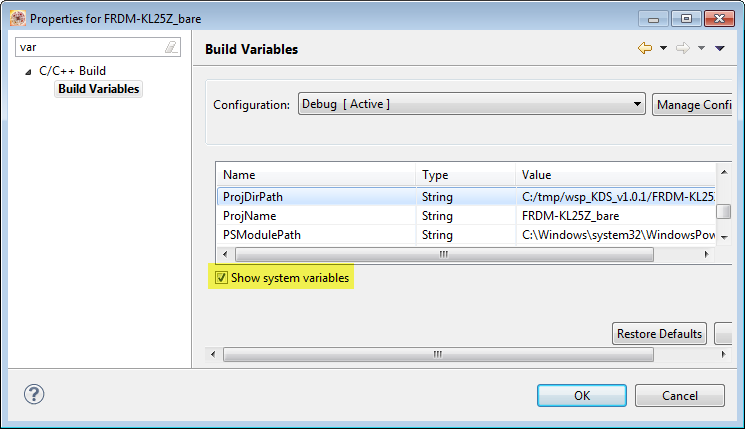

3. Presently path variable are getting dropped when used in the tool settings. For example it is possible to use a linker script path such as "${ProjDirPath}/Project_Settings/script.ld" but if ProjDirPath is replaced by a valid path variable (eg. PROJECT_LOC, which is the same location) it results in the linker just receiving "-T /Project_Settings/script.ld" [the path variable has been completely lost].

1) The build directory is controlled by the build plugin: it uses the configuration name with the project location (in other words: the output folder is the path tot he project folder with the name of the configuration attached. If you want to change the name, then you can use the 'Manage Configurations...' button:

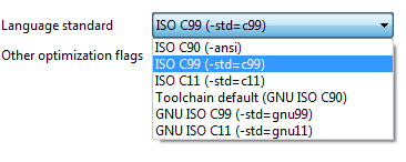

2) It is not because of gcc itself, but of the language option. The default compiler language settings (ISO C99) only accepts __asm():
You could switch it to ISO C90, but my recommendation is to use __asm() instead.
3) Yes, this is a known problem with any Eclipse distribution (with CodeWarrior just one): every Eclipse distribution comes with its own variables, which then might not be present in another distribution. PROJ_LOC to my understanding is an alias used by CodeWarrior from the early 10.0 days. I recommend to use the 'standard' ProjDirPath one. You can get a list of currently visible/active variables with the 'show system variables' check box:
4) Same thing here: CodeWarrior only has this variable. You could use the eclipse_home variable to locate relative binaries.

To 1. I don't want to change the target "name" but the target "build location". I can do this with CW10.5 and also with Atollic.
That is, I want to change the ${workspace_loc:/project_name} part and not change the Debug part.
The reason is that having the output directory at that location causes a "mess" in the project structure and difficulty to maintain output binaries.

To 3 and 4. I can use path variables without problems in CW10.5 and Atollic, but they fail in KDS.
The problem is not that there are differently named build variables between different versions but that one can not use path variables (as defined in "Resouce | Linked Resources"). Even the ones that Eclipse defines as default there can't be used and, although one can define new ones which Eclipse also says are valid they can't be used.
However I have found that I can also define build variables based on system build variables and this then allows these to be used as macros to define, for example, the linker script path.
Path variables are project settings and as long as build variables are also stored in the project this alternative solution is adequate.
