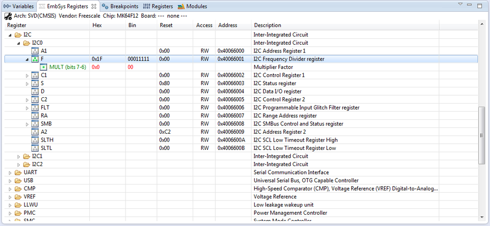

Does KDS have a view that shows all of the registers in the MCU like CodeWarrior?  The register tab in the debug perspective only shows "General Registers", I find that the GPIO/ADC/etc registers are helpful when getting a new piece of code that isn't working properly up and running.  Is this implemented under a setting that I've missed?

BlackNight
Ok, that makes sense now :-)
I have described the steps how to install the plugin (plus the needed patch for Kinetis devices) here:
http://mcuoneclipse.com/2014/05/29/how-to-add-register-details-view-in-eclipse/
Let me know what you think.

DavidS
Hi Mike,
The KDS_3.0 has the EmbSys Registers view already installed.  No need to install it manually.
With the Debug Perspective, Window->Show View->Other...    Then select Debug->EmbSys Registers to see the window.
David

BlackNight
Hi Linda,
The zip file contains an eclipse folder with features and plugins:
You need to unpack these files and place it over your existing eclipse folder of KDS:
it will replace a few files and add all the new CMSIS-SVD files.

BlackNight
Hi Linda,
do not delete anything. Unpack the files over your existing eclipse folder.
Erich

BlackNight
Hi Ryan,
no, you are not missing anything. That CodeWarrior peripheral register view is CodeWarrior specific, and not part of KDS :-( .
However, I managed to this for my FRDM-K64F board:
Unfortunately to get there, it requires some plugin tweaking. I have it running for the K64F and that works fine for me.
Let me know what board/device you are using.
If there is any interest, then I could write up an article how this can be done.
