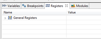

Toe
Does KDS have a view that shows all of the registers in the MCU like CodeWarrior?  The register tab in the debug perspective only shows "General Registers", I find that the GPIO/ADC/etc registers are helpful when getting a new piece of code that isn't working properly up and running.  Is this implemented under a setting that I've missed?

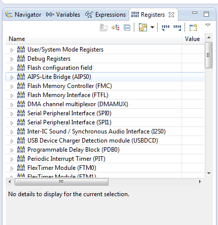

BlackNight
Ok, that makes sense now :-)
I have described the steps how to install the plugin (plus the needed patch for Kinetis devices) here:
http://mcuoneclipse.com/2014/05/29/how-to-add-register-details-view-in-eclipse/
Let me know what you think.
Erich

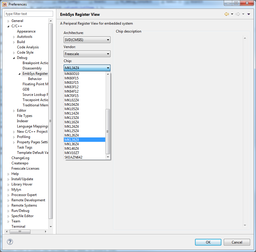

carlnormansuret
Contributor V
I have KDS 3.2.0 and didnt realise it was "already there", anyway, I installed Erich's update, copied the files over, but I have no KL27 support? I can see the KL27 file in the directory C:\Freescale\KDS_v3\eclipse\Freescale\MKL27Z4.xml but it does not come up

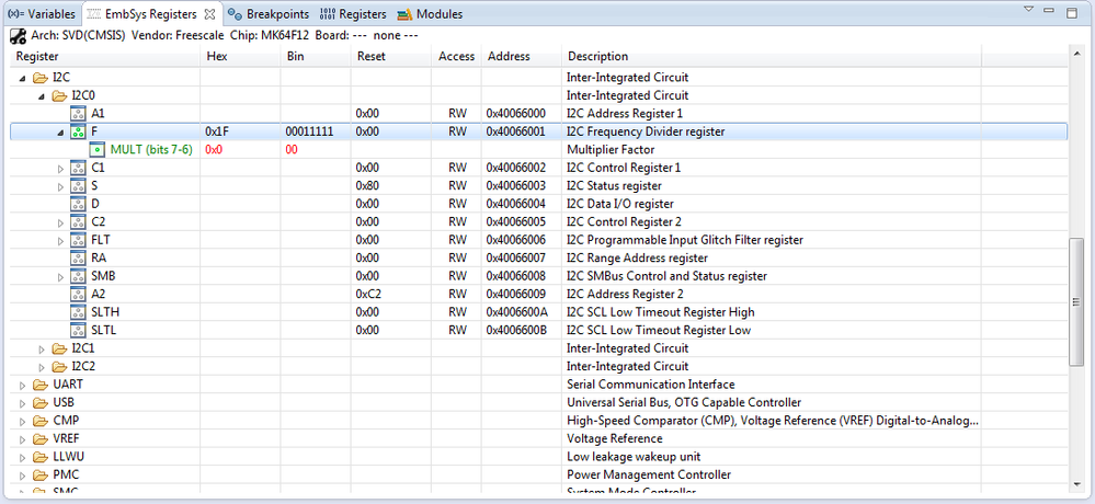

DavidS
Hi Mike,
The KDS_3.0 has the EmbSys Registers view already installed.  No need to install it manually.
With the Debug Perspective, Window->Show View->Other...    Then select Debug->EmbSys Registers to see the window.
David

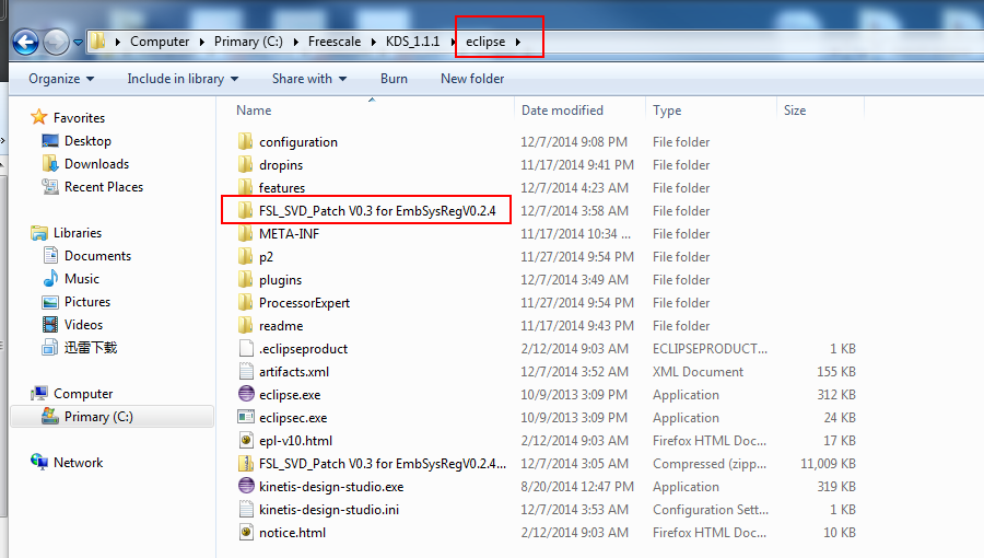

Fan_xy

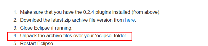

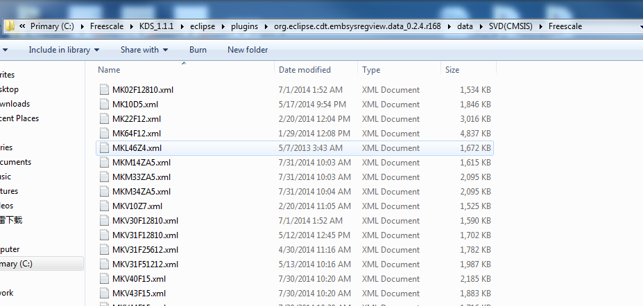

Hi Erich,
I have refer to your tutorials (How to Add Register Details View in Eclipse | MCU on Eclipse) did step by step , and also
Updated Eclipse EmbSysReg Viewer with extra Freescale SVD Files . while in my kds ,it still can't check the freescale' products.
"Unpack the archive files over your ‘eclipse’ folder." can you tell me what's the meaning of this words ? and put the "FSL_SVD_Patch V0.3 for EmbSysReg" to where ?  I put it here :
it doesn't work ,then i put them to here :
it still can't work .
What should I  do ?
9,885件の閲覧回数
BlackNight
Hi Linda,
The zip file contains an eclipse folder with features and plugins:
You need to unpack these files and place it over your existing eclipse folder of KDS:
it will replace a few files and add all the new CMSIS-SVD files.
I hope this helps,
Erich

Fan_xy
Hi Erich,
I can slect the chip of freescale,  while when i click "ok" , it show nothing .

BlackNight
Hi Linda,
do not delete anything. Unpack the files over your existing eclipse folder.
Erich

BlackNight
No, do *not* delete the eclipse folder of KDS. Simply copy the eclipse folder of the zip file over your existing eclipse folder.

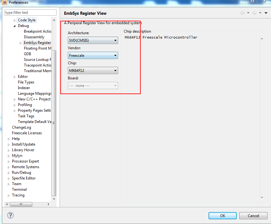

9,885件の閲覧回数
BlackNight
Hi Ryan,
no, you are not missing anything. That CodeWarrior peripheral register view is CodeWarrior specific, and not part of KDS :-( .
However, I managed to this for my FRDM-K64F board:
Unfortunately to get there, it requires some plugin tweaking. I have it running for the K64F and that works fine for me.
Let me know what board/device you are using.
If there is any interest, then I could write up an article how this can be done.
