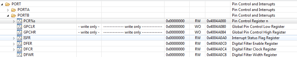

That's pretty simple to install, thanks for putting together such a thorough guide!  Doesn't look like my exact chip is supported, though.  It has a MK22F12 which, like most Kinetis parts, has similar registers.  There are some awkward places that may be due to the part not being correct or not completely supported:
There should be 32 pin control registers for port B, but it only shows the first one.  The location is correct, though.
There are a few other instances similar to this, but overall it is quite useful and better than the default register view.

I have implemented last night initial support for %s (CMSIS-SVD dimElementGroup). Anyone interested to try it out?

BlackNight
attached is an updated plugin (replace your current plugin with it).
I try to publish a short write-up in the blog tonight if I find time.

BlackNight
Yes, these items with the %s only show the first register. There is a problem in this register view because the %s items are 'array of register' items, and they are not handled correctly yet.
Need to see if and how this can be improved in the plugin, as not all aspects of CMSIS-SVD are handled yet.
