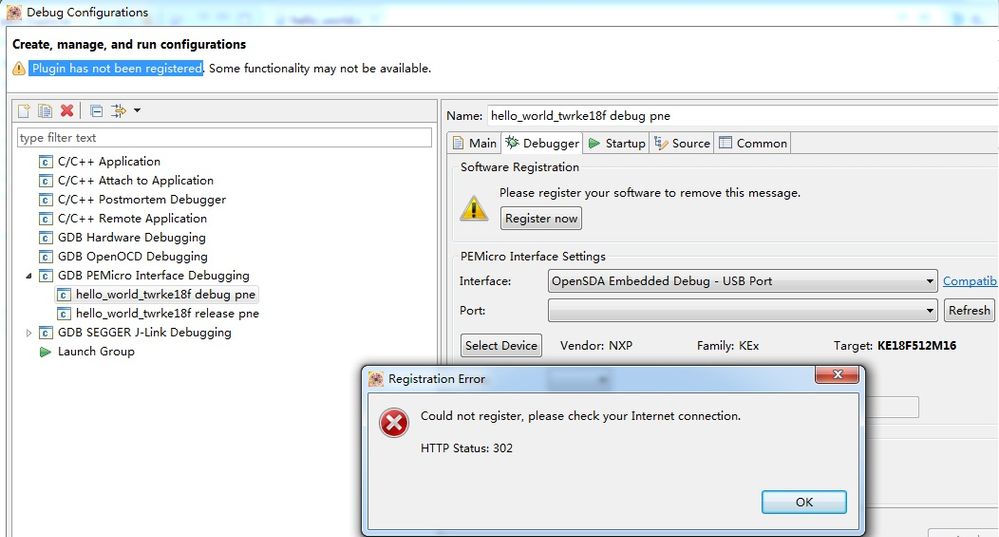

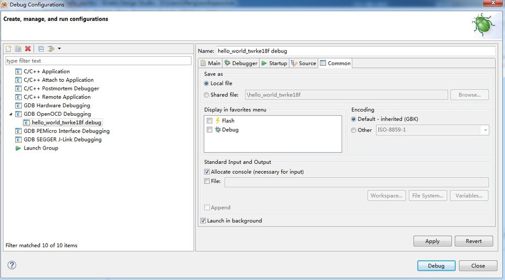

The board is TWR-KE18F, MDK is normal, but in KDS, the system inform  Plugin has not been registered.  Order  the register operation, input my email  address , could not register . I had close the firewall .
Can't debug , can't download fash.

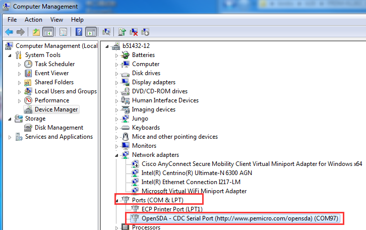

-  Please first check the Device Manager of  PC,  is there the OpenSDA driver?
- Please make sure there isn't another connect with your board .
- About the register , Please make your the network is well .

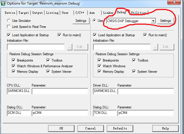

lifeng

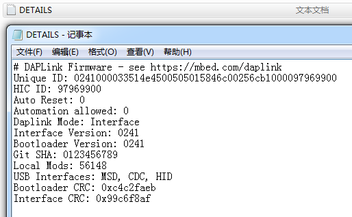

After connect , PC recongised as mbed Serial Port(com5) . How to set it as OPENSDA?
In mdk, set Debug CMSIS-DAP Debugger, work normal,  can bulid or download .

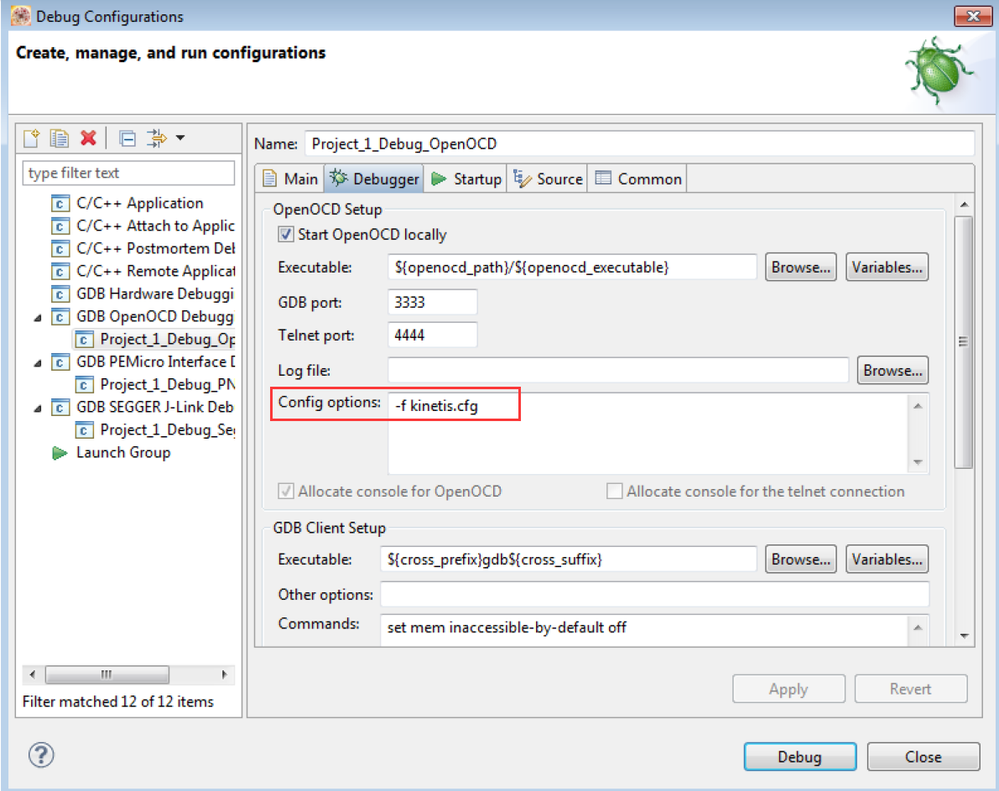

Hello Li,

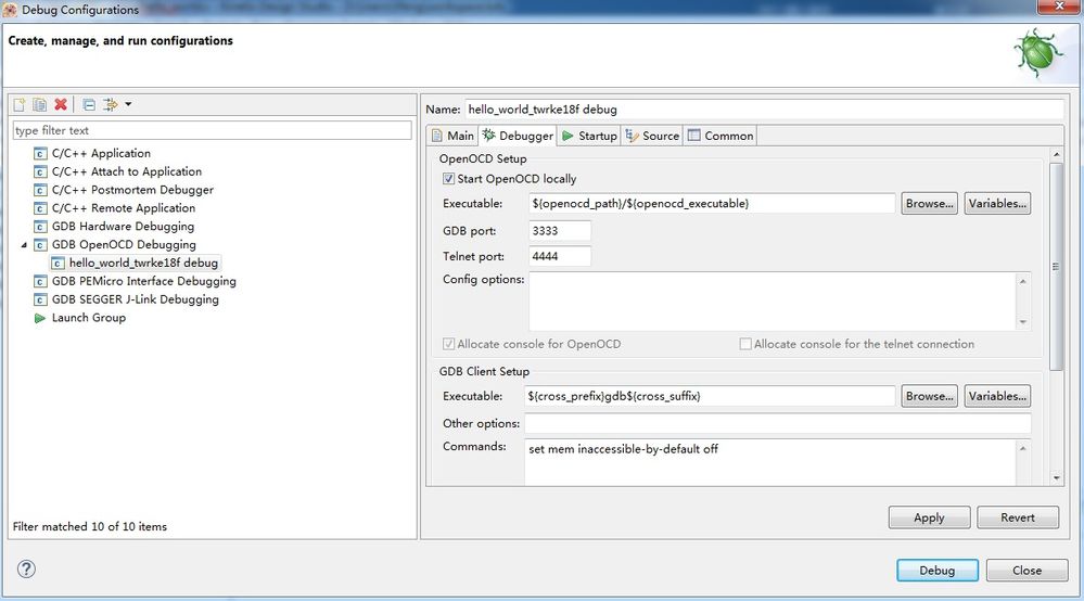

Your board now is MBED firmware, please  choose the "GDB OpenOCD debugging":
If it still can't work , please update the bootloader to Jlink or PEMicro.
Alice

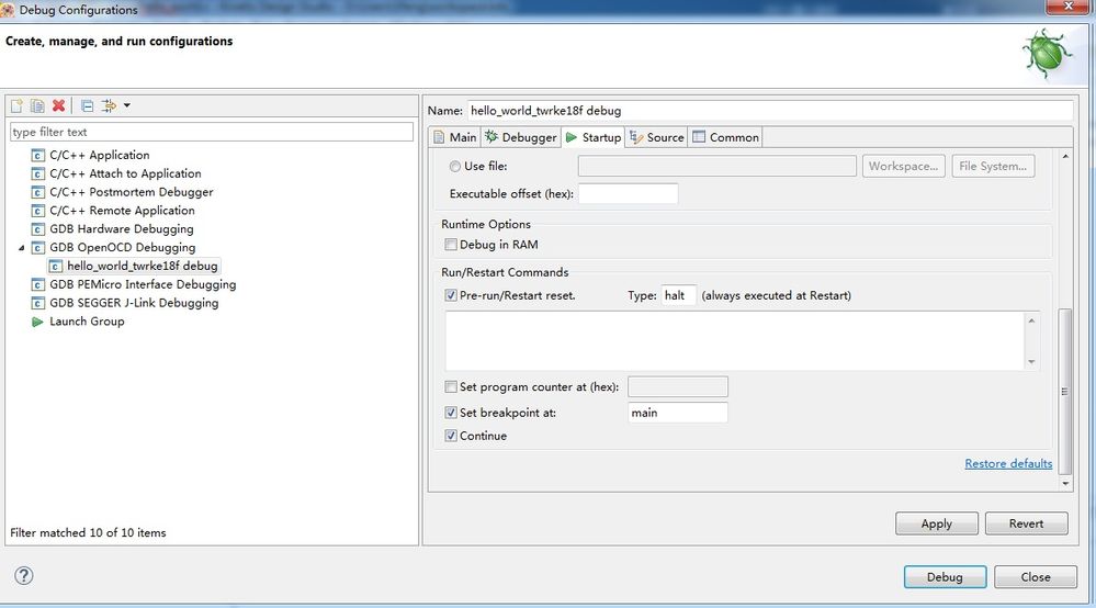

Hello Alice,

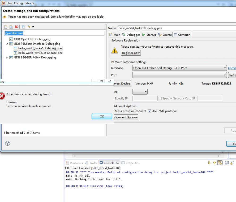

Now the debugger display is normal, but after debugger or flash download, informed missing a configuration.
Whitch is error?

Hello Li Feng,
Please configure the "Config options" as below :
Hope it helps

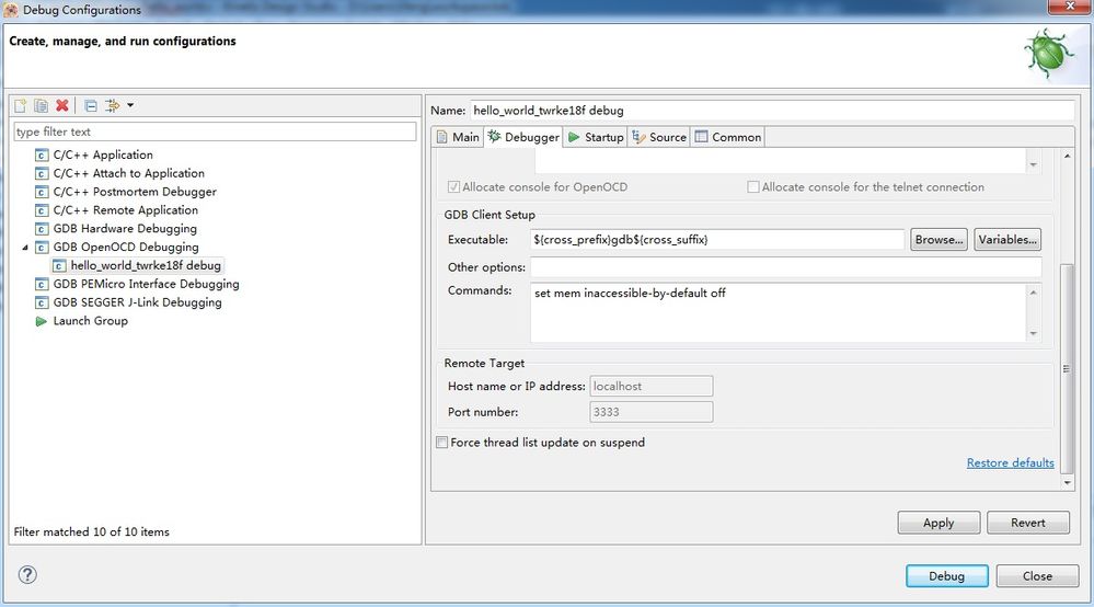

Hello Alice,

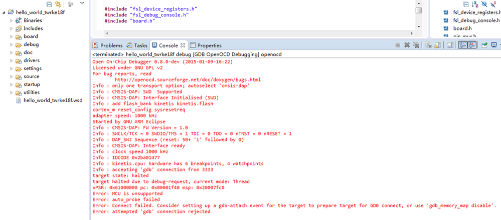

   After change config option, run debug, it says the mcu is unsupported.
But I can't find anywhere to change the mcu for import project, how to change it?
2,666件の閲覧回数
Hello Li Feng,
From the error message "MCU is unsupported" , it seems your device is not supported by OpenOCD, as OpenOCD needs to be implemented for your microcontroller. Have you tried P&E and Segger debug firmware on the board
already ? I recommend you test Segger debug firmware, the steps are as below :
1)Press the Reset button (and keep it pressed) while power the board withthe OpenSDA USB connector:.
2)  The board will show up as BOOTLOADER drive on your system:
3) Copy"29_OpenSDA_TWR-KE18F.bin" to the BOOTLOADER driver:
4) The copy operation takes about 2-3 seconds, after finished , unpower the board.
5) Power the board again normally
Select the "GDB SEGGER J-Link debug" do download and debug :
TIC
