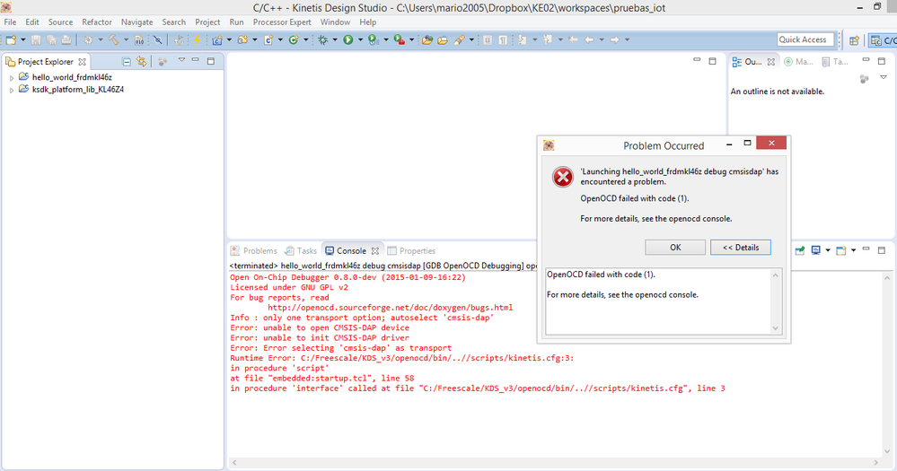

I have been following the step which you have mentioned and also the "Getting Started with Kinetis SDK (KSDK) v.1.3.pdf" application note. However, (after having had built succesfully the library and the example) when I go to "Run -> Debug Configurations -> GDB OpenOCD Debugging -> hello_world_frdmkl46z debug" cmsisdap and try to debug, the following error shows up.
I hope that you can help me realizing what is not working correctly.
Kind regards,
Juan Ignacio Troisi

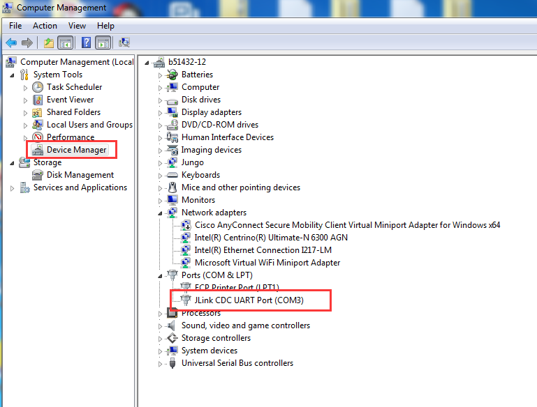

Hi Juan,
- Please open the Device Manager of you PC to check which debug interface on your board.
For example on my board ,it is Jlink :
The Kinetis Design Studio software development tools
supports the following debug adapters for debugging
applications on a Freescale Kinetis device.
• OpenOCD - On-board OpenSDA debug interface
running the ARM® mbed™ project CMSIS-DAP
firmware.
• P&E USB Multilink Universal and USB Multilink
Universal FX debug adapters.
• SEGGER J-Link and J-Trace debug adapters.
- After check , please refer to the KDS_USER_Guide -> 2.5 Debugging Projects  to debug your project.
Hope it helps
Alice

Hello Juan,
From your another case Not able to debug FRDM KL46z    I know your system is Win8.1,
please use the P&E debug firmware, there is a same question with yours,  refer to it :
hello everyone, recently i have bought frdm kl-46z board. but i got a problem loading driver for win...
Hope it helps
