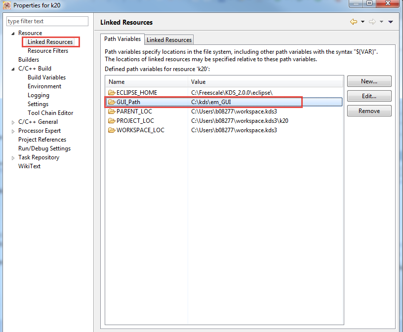

Right now I have a couple of include paths that are "literal" or hardcoded, whatever you want to call it.  For example:
C:\kds\em_GUI\include
C:\kds\em_GUI\Core
etc.
I would like to make them relative, using a new path variable, called "${GUI_Path} or something like that.  Where ${GUI_Path} is "C:\kds\em_GUI"
I have tried adding "GUI_Path" to Properties --> Build Variables, but KDS does not see it.
Mike

I suggest you add "GUI_Path" to linker resources:
can this help?

Hello Zhang Jun,
I added "GUI_Path" in Linked Resources, with value "C:\kds\em_GUI".  Then, in my C compiler Includes, I added:
"${GUI_Path:/include}"
and
"${GUI_Path}/include}"
but it didn't work.  Is there something else you can think of?

after you define build variable then you add the path to ARM C Compiler Include paths setting. this should work.
if not work for you, please upload your project, we can check it. thanks!
