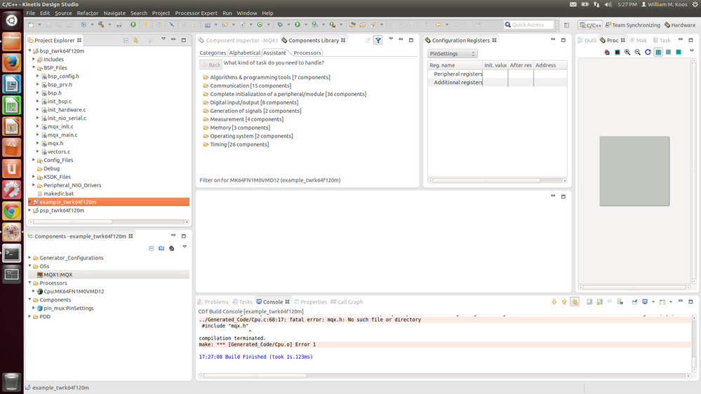

I created a new simple "Hello World" project using the processor expert that builds and runs fine on my TWRK-21F120M board. I then try to add the MQX component and it fails the build with this error:
arm-none-eabi-gcc -mcpu=cortex-m4 -mthumb -mfloat-abi=hard -mfpu=fpv4-sp-d16 -O0 -fmessage-length=0 -fsigned-char -ffunction-sections -fdata-sections  -g3 -I"C:\Freescale\KDS_1.1.0\eclipse\ProcessorExpert/lib/Kinetis/pdd/inc" -I"C:\Freescale\KDS_1.1.0\eclipse\ProcessorExpert/lib/Kinetis/iofiles" -I"C:/Users/Billy/workspace.kds/example_twrk21f120m/Sources" -I"C:/Users/Billy/workspace.kds/example_twrk21f120m/Generated_Code" -std=c99 -MMD -MP -MF"Generated_Code/Cpu.d" -MT"Generated_Code/Cpu.o" -c -o "Generated_Code/Cpu.o" "../Generated_Code/Cpu.c"
../Generated_Code/Cpu.c:62:17: fatal error: mqx.h: No such file or directory
#include "mqx.h"
compilation terminated.
make: *** [Generated_Code/Cpu.o] Error 1
I have installed the MQX plugin from the update site.

The error indicates that it is looking for the MQX header files, but they are not present in the project or cannot be found.
unlike the MQX-Lite component, this componet does *not* implement (or generate) the MQX sources. What it does is adding MQX Kernel awareness (as an adaptor) and interface to other components. So if you want to use MQX with your project, you need to add the MQX kernel and BSP/PSP sources/libraries to your project, and add to the include path settings of the compiler.
The SDK or the MQX for the SDK unfortunately does not help you in your case, because the K21 is not supported in the Kinetis SDK V1.0.0 release, so you have to use the 'standard' MQX version. An easier approach for you might just to use the MQX-Lite, unless you really need the additional functionality of full MQX.

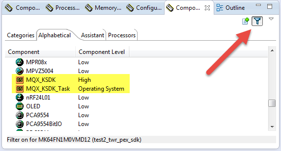

If you have created the project with the SDK option, then only SDK components apply. the other ones are automatically filtered out (filter icon):
So if you want to use the (non-SDK) MQX, then you need to create the project with the SDK option disabled:

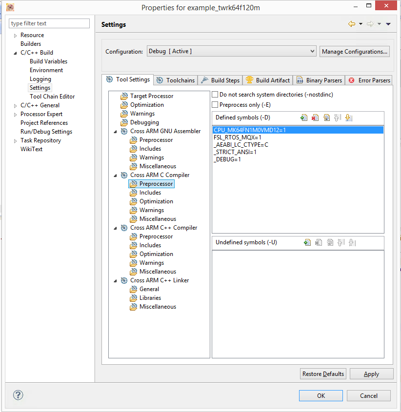

I've about run this to ground, at least in the Windows environment. I can resolve a lot of the build issues by including directories in MQX_KSDK_1.0.0 and setting some preprocessor defines. When I do that I get re-definitions of the same macros so I believe there is a conflict between using MQX_KSDK_1.0.0 and Processor Expert. I thought the MQX plugin would bridge the gap but I'm either doing something wrong or it just doesn't work that way. Here are the steps I took:
Step 1: Define some helper environment variables, MQX_KSDK_DIR and MQX_DIR to point to directories within MQX_KSDK_1.0.0.
Step 2: Add include paths for Cross Arm GNU Assembler using the hello_twrk64f120m project as a guide:
Step 3: Add preprocessor defines to Cross ARM GNU Assembler:

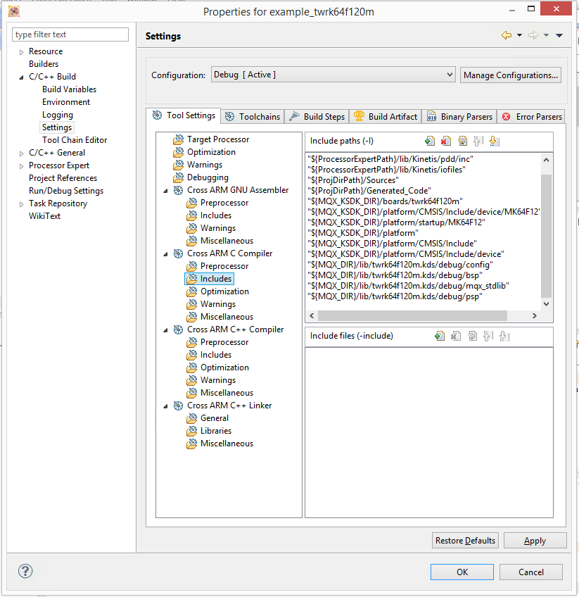

Step 4: Add include paths to Cross ARM C Compiler:
Step 5: Added preprocessor definitions to Cross ARM C Compiler:

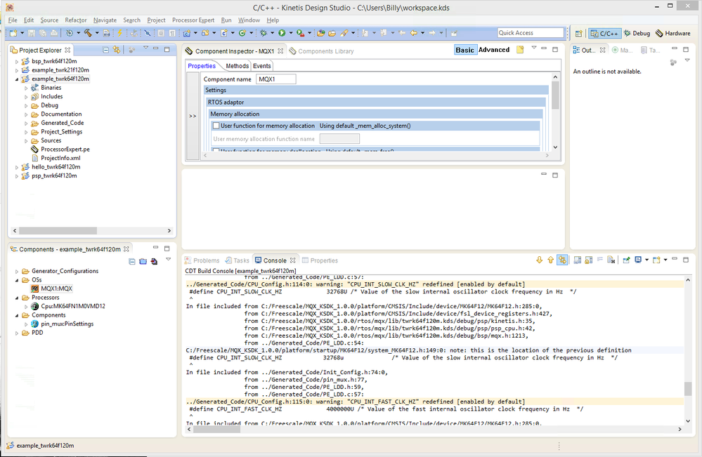

After this the build finds all the files and actually generates binaries but with conflicts between the include files generated by Processor Expert and those in MQX_KSDK_1.0.0:
So at the moment it looks like I have to abandon Processor Expert if I want to use MQX. Any suggestions?

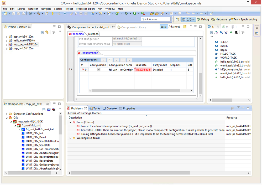

That cleared an awful lot up for me. The new tutorial is excellent. I have run into one problem when I attempt to set the fsl_uart1 component for UART1, PTC3,PTC4 that are used on the TWR-K64F120M. The code generator errs off saying that it is impossible to set the baud rate to 115200. I've attached a screen shot.

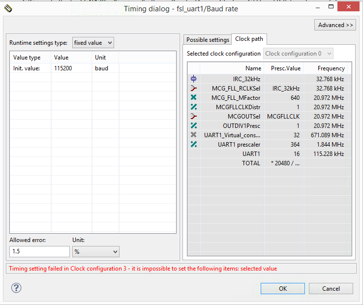

If I click on the baud rate selector in "Configurations" it takes me to a screen where I can look at the clock tree and it looks like 115200 should be fine. I've attached that screen shot as well.

You should try to break these different issues out into separate posts.  But regarding the PEx issue with the UART baud rate error, from your screenshots, that appears to be caused by multiple clock configurations in your CPU component.  The error message shows Clock Configuration 3 has the issue generating that baud rate.  And when you show the clock path in the timing dialog, it is for Clock Configuration 0.  My guess is that your Clock Configuration 3 uses a peripheral bus clock frequency that is not fast enough for a 115,200 baud rate for that UART.
The Timing Dialog does show information for the different clock configurations if you click the Advanced button.  But it appears the Clock path is fixed on Clock Configuration 0.  And the baud rate appears to need to be the same for all clock configurations.
Unfortunately, with the MQX_KSDK and fsl_uart components, I don't see how to disable the UART for specific clock configurations, or change the baud.  I'll submit that to the PEx team to see if there is an option.  But to work around the error and generate the PEx code, you may need to delete Clock Configuration 3 from your CPU component, or change the System Clock frequencies so your desired baud rate is possible in that Clock Configuration.
6,510 Views
dereksnell
Hi William,
I confirmed this multiple clock configuration issue is a limitation with PEx for KSDK.  We plan to update it in the KSDK release v1.1.

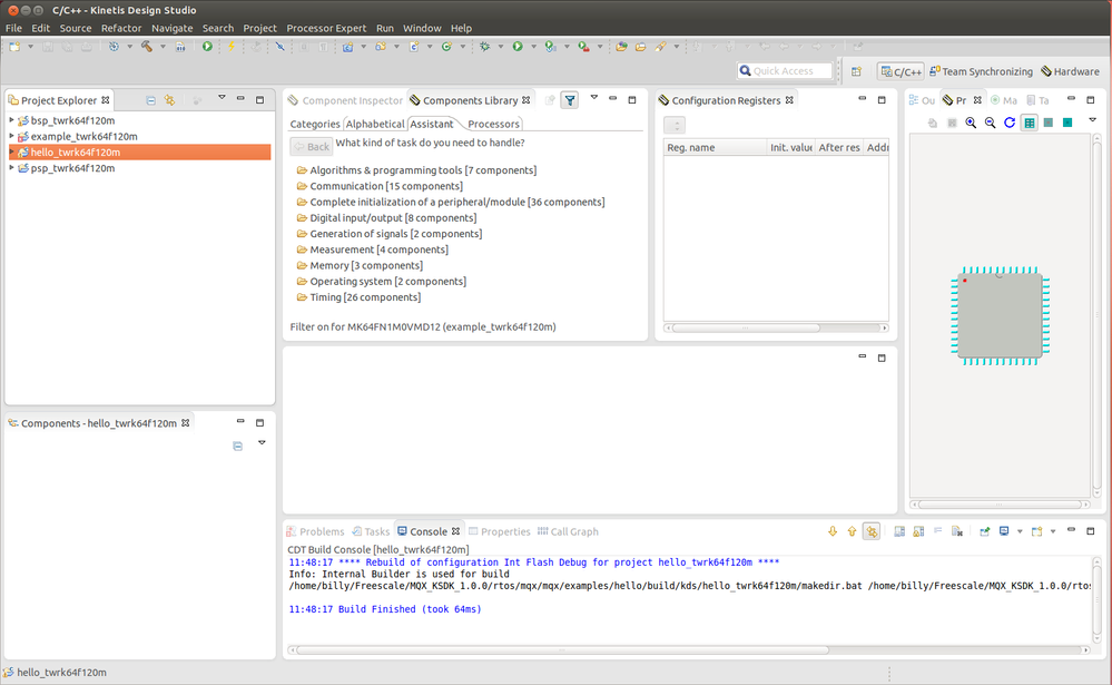

I'm getting closer using the windows variants(instead of Ubuntu) in that I'm able to build hello_twrk64f120m using the procedure described in "Getting Started with Freescale MQX RTOS for Kinetis SDK.pdf" However, hello_twrk64f120m is an existing project and clearly doesn't take advantage of Processor Expert code. I'm still getting the same error as above when I create a new project using Processor Expert and add in the MQX component.
The odd thing about the Ubuntu variants  of bps_twrk64f120m and pep_twrk64f120m is that they don't seem to really build anything even though they report "Build Finished". The same is true when I build hello_twrk64f120m and it does not create any binaries.
I've attached screenshots of both:
