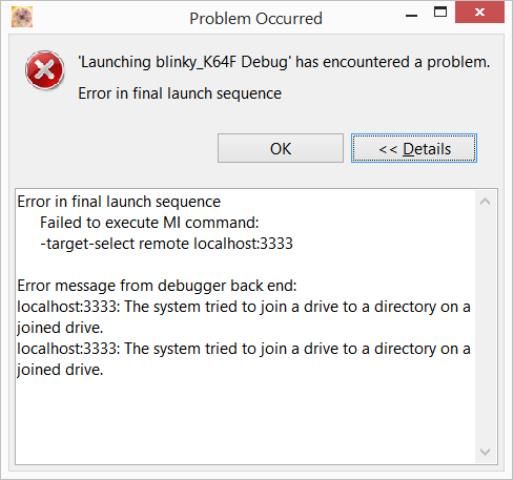

I tried an FRDM-K64F. Was able to get it to work with OpenOCD/Segger J-Link firmware but can't get it to go into debugger with OpenOCD/CMSIS-DAP.
I tried the latest firmware 20140530_k20dx128_k64f_if_mbed.bin. It displayed these messages in the Console then went silent:
When I manually switched to Debug perspective, I see this:

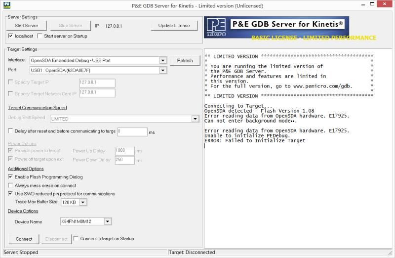

I tried an older version of the firmware: DEBUG_K64F_MBED_PEMICRO_V108.bin, which gave me the following error:
When I tried DEBUG-FRDM-K64F_Pemicro_v108.bin firmware, it would not communicate with P&E GDB Server.

you really need to use
-f kinetis.cfg
otherwise I'm not surprised that you face problems.
Another issue I have seen with OpenOCD and CMSIS-DAP (at least with the 0203 firmware from the mbed site): You need to power the board twice before it can be debugged. There is a note about this in the release notes, but probably not clear.
As basic steps:
a) plug in the FRDM-K64F board (using the OpenSDA plug).
b) unplug the board
c) plug in the baord again
d) now you can debug the board with OpenOCD/CMSIS-DAP
It is not clear to me why this is so strange, but that way I was able to debug the board as expected.

if you have the mbed/CMSIS-DAP firmware loaded on your board, then you only can use it with a CMSIS-DAP aware connection (e.g. OpenOCD). So trying to connect to it with the P&E GDB server (or Segger GDB server too) will fail, so no surprise.
Your first screenshot indicates that you are not using the correct configuration kinetis.cfg file. See screenshot below.
The other thing I saw sometimes (and might be related to your issue): I have seen cases that if debug connection with CMSIS-DAP fails, it is necessary to re-power the board, and then it is ok. I have already filed a ticket about this.

For FRDM-K64F, I have tried three firmwares:
1. mbed/CMSIS-DAP firmware
2. P&E OpenSDA with GDB Server
3. Segger J-Link
Only #3 gave me consistent success debug connection.
#2 GDB Server gave me E17925  error all the time.
#1 debug connection is touchy. The first time I set it up, it would not work as described above. I play with mbed, reset, and disconnect/reconnect USB and it worked sometimes but not all the time. I have yet to find the pattern.  I did read that k64.cfg is deprecated and tried kinetis.cfg but kinetis.cfg did not get me anywhere. I finally realized that I should replace
-f target/k64.cfg
with
-f kinetis.cfg
but I was using
-f target/kinetis.cfg
and that seemed to be the problem.
I could get my simple blinking LED program to work most of the time now.
