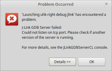

Hi guys,
From time to time, the following error dialog appears when trying to download the firmware to an FRDM board:
This is a major productivity problem for me, because the only way to reliably recover from this error is to detach the board, exit and re-launch KDS, attach the board, and re-download the firmware. Sometimes I'm able to download the firmware about a dozen times in a row without bumping into this error, other times it occurs almost every time.
The content of the JLinkGDBServerCL console:

ERROR: Failed to bind address (Err = 98)
ERROR: Failed to open listener port 2331

there is customer having similar problem as yours. he solved the problem with below thread:
arm-none-eabi-edb.exe in KDS 3.0.0 failing after J-link firmware update
can it also work for you?
Jennie Zhang

what KDS version do you work with?
do you use NXP FRDM board or external J-link tool?
Jennie Zhang
11,172 Views
laszlomonda
Contributor V
Hi Jennie,
I use KDS 3.1.0 with the internal OpenSDA programming port of the FRDM boards, without an external programmer.
Thank you!
- Laci
11,170 Views
ZhangJennie
Hi Laci,
from my understanding, you use FRDM-K22 board, I suggest you update your board firmware with JLink_OpenSDA_V2_1_2015-10-13.bin (see attached) then test it again.

Actually, I was already using the latest J-Link OpenSDA firmware. I've given P&E a try this time but it seems that it's not better. It takes about 10 seconds to download the firmware to the board, and I get "Error in services launch sequence" error message very often.
Cheers!
