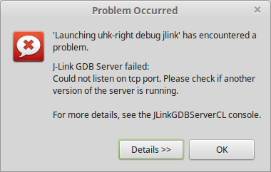

Hi guys,
From time to time, the following error dialog appears when trying to download the firmware to an FRDM board:
This is a major productivity problem for me, because the only way to reliably recover from this error is to detach the board, exit and re-launch KDS, attach the board, and re-download the firmware. Sometimes I'm able to download the firmware about a dozen times in a row without bumping into this error, other times it occurs almost every time.
The content of the JLinkGDBServerCL console:

ERROR: Failed to bind address (Err = 98)
ERROR: Failed to open listener port 2331
Restoring target state and closing J-Link connection...
Shutting down...

what KDS version do you work with?
do you use NXP FRDM board or external J-link tool?
Jennie Zhang

laszlomonda
Hi Jennie,
I use KDS 3.1.0 with the internal OpenSDA programming port of the FRDM boards, without an external programmer.

ZhangJennie
Hi Laci,
from my understanding, you use FRDM-K22 board, I suggest you update your board firmware with JLink_OpenSDA_V2_1_2015-10-13.bin (see attached) then test it again.
if still can not connect, I suggest you download and install the latest J-Link software package
https://www.segger.com/jlink-software.html
Segger J-Link OpenSDA Firmware update procedure:
  1. Disconnect all power, external circuits and USB cables.
  2. Press and hold the button marked RESET (circled in picture)
  3. Connect a USB cable with debug interface as shown in above picture
  4. The drive should mount named BOOTLOADER in windows explore
  5. The reset button can now be released
  6. Drag and drop the file JLink_OpenSDA_V2_1_2015-10-13.bin onto the USB drive named BOOTLOADER
  7. Repower on board normally
  8. Jlink CDC UART Port will show up in windows device manager.
  9. Then user can download and debug code via KDS3.0 debugger Segger J-Link OpenSDA interface.
if jlink interface can not work for you anyway, I suggest you try P&E OpenSDA. the bootloader image is also attached.
can it help you?

laszlomonda
Thank you very much for your help, Jennie!
Actually, I was already using the latest J-Link OpenSDA firmware. I've given P&E a try this time but it seems that it's not better. It takes about 10 seconds to download the firmware to the board, and I get "Error in services launch sequence" error message very often.
