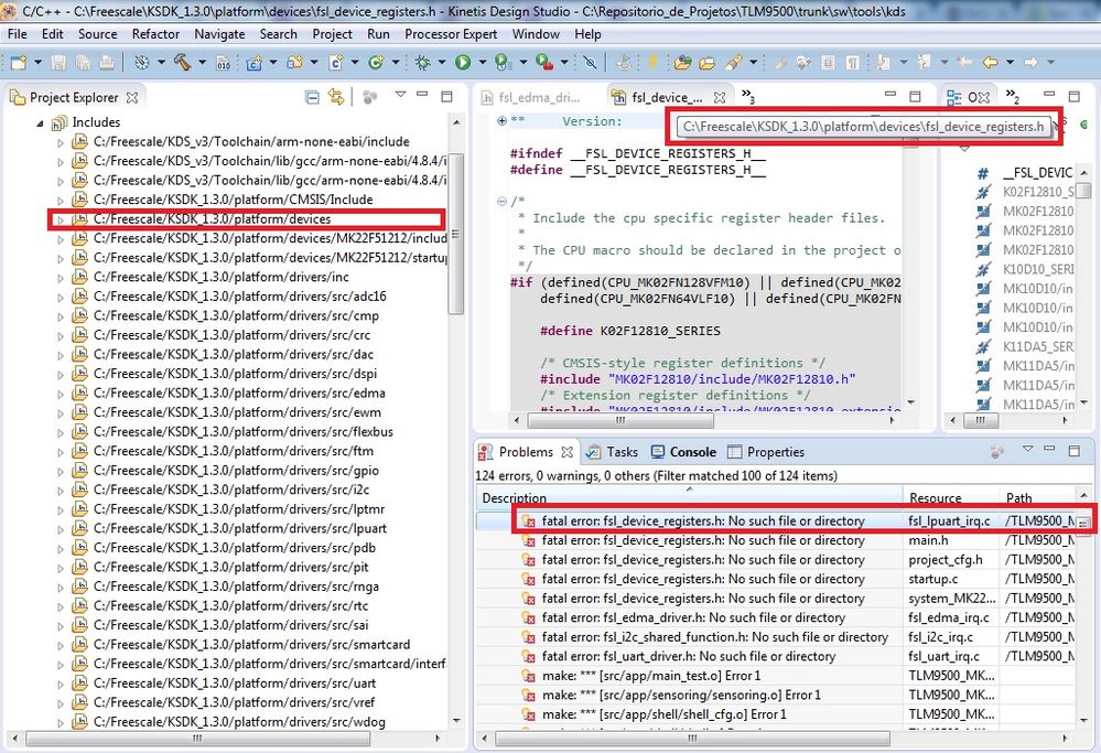

Hey there, I installed KDS 3.2, but now I am having an error when trying to compile my project. The header file of some KSDK (1.3.0) files cannot be found now. Do you have any idea what could be causing that?

Hi Denis,
I had this problem with a project once and it was caused because the include paths on the project settings did not have quotation marks, maybe this is the case?
Let me know if it helps!

Thank you Carlos, that worked!
