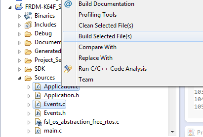

I am using KDS 2.0 and in a KSDK / Processor Expert project. "Build Selected File(s)" is always grayed out. I thought it might be an Eclipse issue, but from my research it may have to do with settings done when the project was generated.
Does anyone know of workaround or fix to get this working?

On my side, I can select files and do "Buid Selected Files(s)", and it is not grayed out:
But of course only select files which are 'buildable' (e.g. do not select header files, as they on their own are not buildable). So select e.g. only *.c or *.cpp files.
Maybe this is the problem you see (that you have selected files which cannot be built)?

Nope. I am only selecting .c and .cpp files but "Build Selected File(s)" never becomes available, even though I am 100% certain I am building them when I build the project. :smileysad:
Hmm.... I re-imported the project to get the SVN status picked up by my Subclipse plug-in and the behavior is different. I selected my "Thread.cpp" file and "Build Selected File(s)" was not grayed out, but when I tried it I got a pop up message saying "The chosen operation is not enabled.". :smileysad:

I can say that it works for me. I'm using Windows (7, 64bit, but this should not matter) with a project created by KDS.
It works for me with all the projects I have created as far as I can tell. Not sure what should be different for your projects.
You can find my projects on GitHub, e.g. https://github.com/ErichStyger/mcuoneclipse/tree/master/Examples/KDS
Using SVN should not matter (I had used SVN in the past and it worked for me there too).
