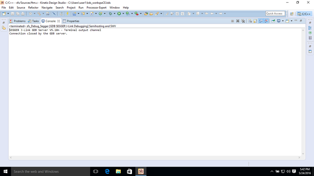

    I am using KDS3.2. I used a project in a different system it is working well.But When I use it in this system then It shows me Errors like Connection Closed by GDB Server, Failed to execute MI command etc150233_150233.pngScreenshot (6).png150234_150234.pngScreenshot (5).png150235_150235.pngScreenshot (4).png

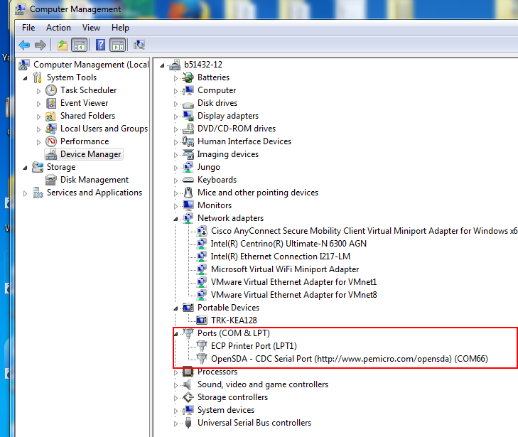

1) Please be sure the firmware of your board  from the computer management, does it j-link ?
take a screenshot about this to me :

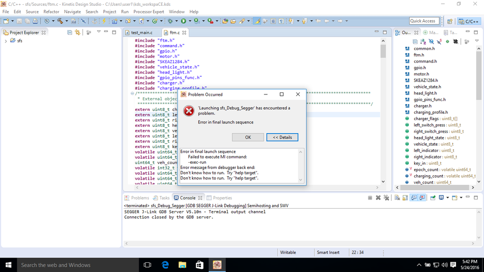

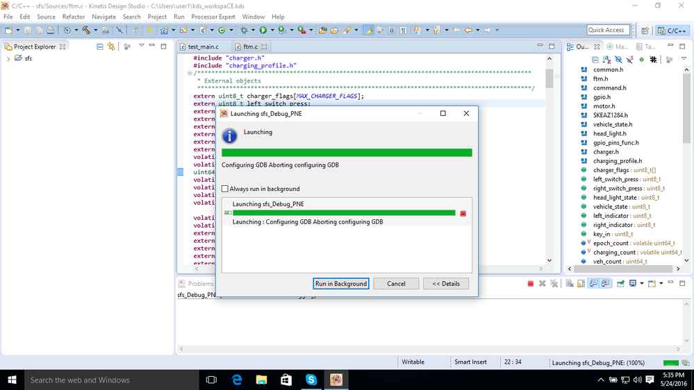

While Trying with Open SDA The Flashing Took very much longer that I have to cancel it, I have attached the Screenshot  of it in pic 1.Then Second Time it throwed an error for which also I have attached a Screenshot in pic 2.

I want to know the exact problem behind this and to solve it.

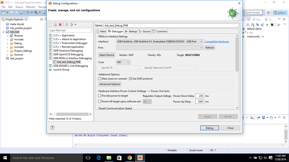

I am getting a Debugger settings like this the port is not selected.Screenshot (31).png

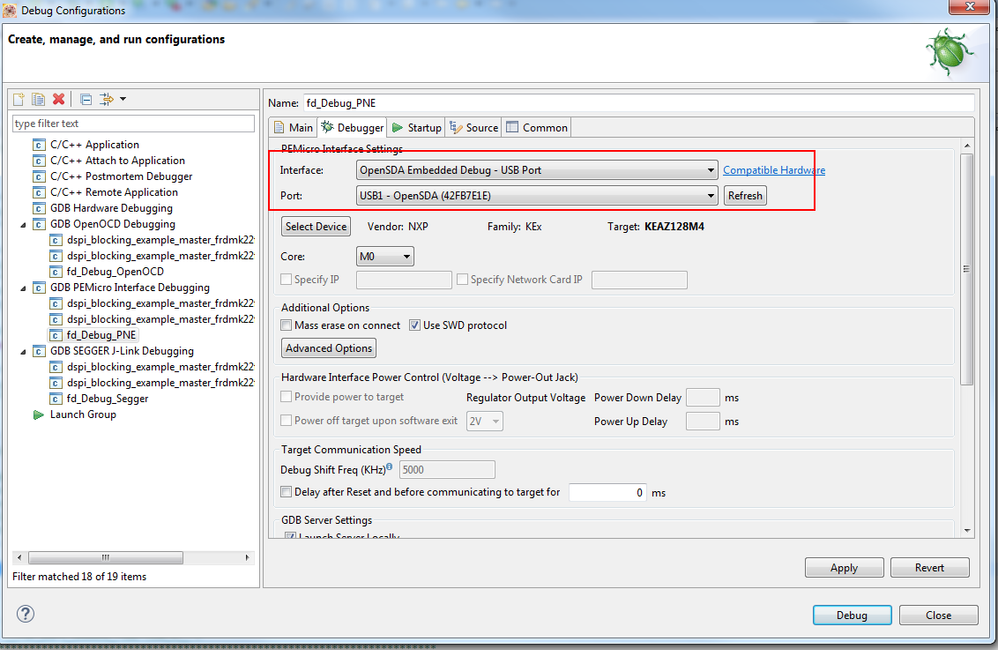

When you use the Open SDA to debug , please configure the debugger as this :
Hope it helps
