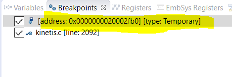

This is something that I am seeing on a KL25, for example. All is find until I command a RUN and then I get this (note that the board is running correctly when it happens but the debugger seems to believe that it has halted it for some reason):
This means that it is no longer possible to pause the operation or set new breakpoints etc. It is only really possible to command a restart. Sometimes a restart command allows it to reset and begin again but often there are errors and it has to be disconnected to start from scratch again.
In the breakpoint window there is also this strange temporary breakpoint which the debugger "thinks" that it has hit (the second is a real breakpoint at the start of code to help stopping it run out of control after a restart command):
If I disable the strange breakpoint it still behaves the same. And if I command a restart it re-inserts the breakpoint in the list again.
The breakpoint address is in SRAM. It is very close to the stack pointer value that is loaded from the reset vector (which is 0x20002ff0), in fact 64 bytes lower than it.
I don't know where this breakpoint comes from or whether it is the cause of the difficulties but the fact is that it is IMPOSSIBLE to halt running code and this is the only hint that is coming from the debugger that is visible.
