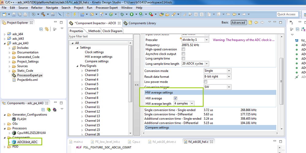

I use Processor Expert in KDS3.2 with SDK1.3 for FRDM KL43z.
I can't find HW average settings.

Hello Andrey,
You can use the  component of "Init_ADC" :

agor53
Hi, Alice
Thank you very much, I was blind to see this component.
