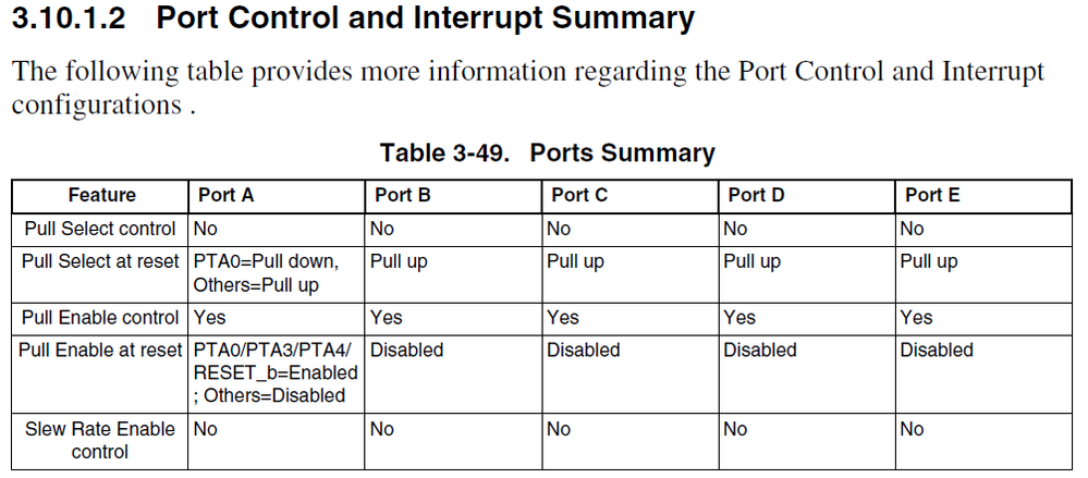

Pin Control Register contains the bit PS(Pull Select), however, this bit is read only for pins that do not support a configurable pull resistor direction.  Please see the description for PORTx_PCRn in Reference Manual.
KL25 has pull-enable control, but only to enable pull-ups (pull-down for PTA0). Pull select is not available at any port. Please also open KL25 Reference Manual, go to the Chip Configuration Chapter->Human Machine Interfaces->GPIO configuration->Port control and interrupt summary Section.

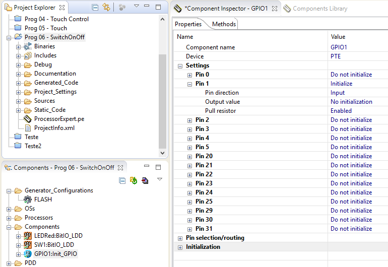

I tried to build a simple example with FRDM-KL25Z board. But when I set "Init_GPIO" (see bellow) exist just three options (Pin direction, Output value and Pull resistor).
Probably I made some mistake. How do I have other options?
Could you help me?
Arnaldo

the KL25Z only has pull-ups available in the hardware, so you don't have a choice to select pull-up or pull-down.
Erich

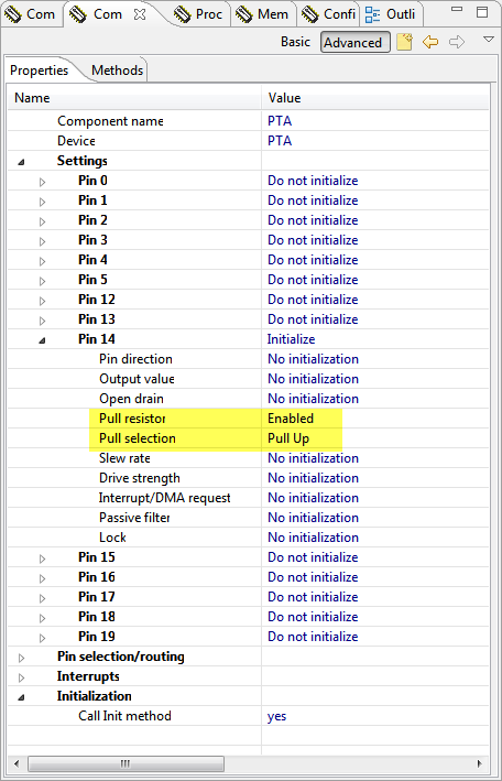

In other post (https://community.freescale.com/thread/327975) you indicated this link: https://mcuoneclipse.com/2012/11/12/tutorial-bits-and-pins-with-kinetis/
The author used CodeWarrior 10.3 according to my understanding of the post, is possible to configure pull-up or pull-down. The topic 11.5.1 in KL25Z Reference Manual we have PS (Pull Select) registry responsible for setting.
Knowing that the processor is the same I don't understand because in CodeWarrior has this option (Pull Select) and in the KDS don't have!
Arnaldo
