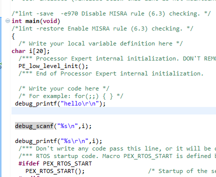

I compiled my code on KDS for FRDM-K64F. I got the elf file but I am not getting the output on tera term. I have set the baud rate=115200, data bits=8, no parity bits and 1 stop bit. Also the size of the .elf is 1.98mb. I would appreciate if someone could help me
6,078 Views
Hello Kiran,
If you want use the printf function of KSDK , the name is "debug_printf", "debug_scanf":
please be careful that in the function of "debug_scanf" , the IO_MAXLINE is 20
you can refer to your demand to change it .
I also attached my project .

kirantujare
Hi Alice,
My program is working on teraterm but I cannot see the scanf values I enter. It does the calculation correctly though. Also the teraterm out is spaced. Can you provide some solution for it? I have attached how my output looks on tera term

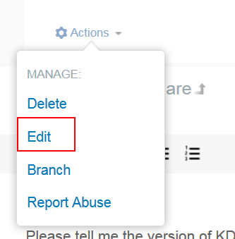

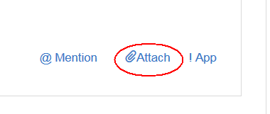

Hello Kiran,
Please tell me the version of KDS, and also the KSDK version , KSDK1.2 OR ksdk 1.3 ?
Then please send file you changed , the method is click the "Actions" button , then click "Edit" ,
then you can find the "attach"
Alice

kirantujare
Hi Alice,
I was confused with the use of PE. I tried a simple "Hello World" program with PE, it worked. I cannot make scanf work on tera term. My project is to design a frequency generator(pattern generator with 1 and 0 bits) for crank and cam. Is it possible to run my code with KSDK+PE. I have attached my original C code below.
