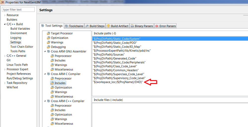

I'm using KDS 3.0 and having a problem building my project due to paths not being updated.
Notice the "D4D" directory is in my include path.  However, when I compile the project, this path is not included in the search:

../Supervisory_Code_Level/MyMain.c:20:17: fatal error: d4d.h: No such file or directory
#include "d4d.h"
compilation terminated.
make: *** [Supervisory_Code_Level/MyMain.o] Error 1
How do I get KDS to recognize the new include path?

Hello Michael,
it seems that there is long problem in the Eclipse with eclipse variables nesting - see https://bugs.eclipse.org/bugs/show_bug.cgi?id=273705
If you project is located directly in your workspace (is not linked somewhere else), you can change your variable to "${workspace_loc}/${ProjName}/D4D"

This has cleared up the problem!  Thank you!
