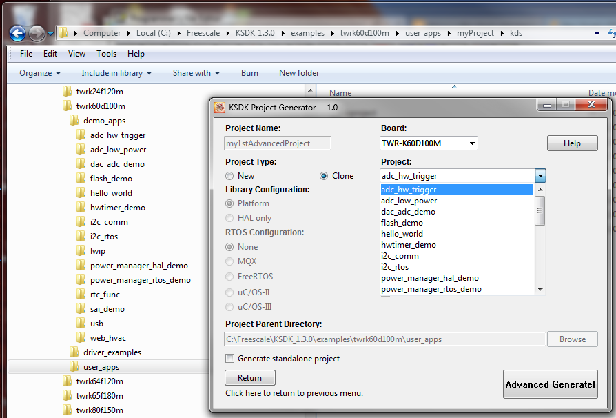

garylynch
I finally got KSDK Project Generator up and running on my
workstation but am unsure how to accomplish what I want with
it.  I will re-explain my objectives and ask you to tell me
what I got wrong.
1. I want to develop test applications on a Tower
    TWR-K60D100M board in preparation to fire up a new
    a new board (with a K10 process)--still in manufacture.
    Everything I get working on the K609 has to be ported
    over to the K10. I am primarily testing peripherals (e.g.
    digital I/O, analog in, CAN bus, SPI port, etc) one at a
    time.
2. The projects in the SDK cannot be 'imported' in the
    generic sense of that word. Any modifications I make
    will change the SDK base code.
3. The Project Generator (under the [Advanced] button) will
    let me clone projects inside the SDK and modify the
    clones without destroying the original projects. I still
    have to pseudo-import the cloned SDK projects into KSD.
4. The clonable projects appear to all come from the
    'demo_apps' section of the SDK (see screen shot).
    I am  working on a CAN driver today, and find it only in
    'driver_examples' section of the SDK.
Is there any way to use these tools to generate a CAN
driver?
Thanks.
