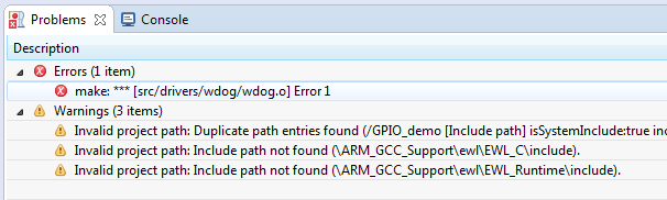

I have a FRDM-KL02Z evaluation board, along with the downloaded example projects. When I import an example project into KDS, I first must convert it from a Code Warrior project to a KDS project. Upon compiling, I am getting 3 warnings:
These same errors occur regardless of which project I import. Any help would be much appreciated.

Hello Andrew,
There is a tutorail  about porting project from CW to KDS, you can have a look :
Importing MCU V10.6 projects (sample, using PE and MQX) under KDS
If can't work ,I recommendy you directly create a new project on KDS, then copy&paste the application code
into it .
